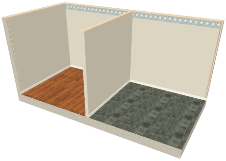

I have added wallpaper, wainscoting, paint or another material to one of my walls using the Wall Covering tool. The problem I am facing is that the wallpaper now appears in several rooms - not just the one that I added the wall covering to. How do I make the wall covering just appear in one room?
ANSWER
When a wall covering such as wallpaper is applied to a wall, it will cover that entire wall. If that wall spans multiple rooms, the wall covering will display in all of those rooms. This can be avoided by dividing the wall into separate segments and specifying the wall coverings for each segment individually.

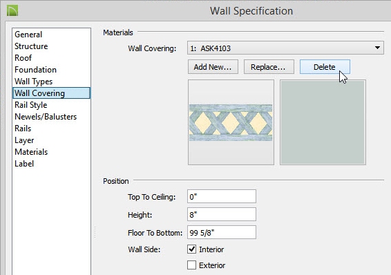

  4. Now that the wall is divided into segments, click the Select Objects  tool and click once on a segment of the wall that should not have a wall covering to select it.
  5. Click the Open Object  edit button to open the Wall Specification dialog, and select the Wall Covering panel.
    • To remove a wall covering from the wall, select it from the Wall Covering drop-down list and click the Delete button.
    • To replace the wall covering with another material, select it from the drop-down menu; click the Select button; and browse the Materials library for a new material to replace it with.
    • If you click the Add New button and select a new wall covering material without deleting the original, the new material will be applied under the original and may not be visible.
  6. Click the OK button to close the Wall Specification dialog and apply your changes.
