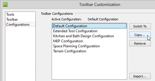

  3. On the Configurations panel of the dialog:
    • Click on a configuration in the list that is most similar to the custom configuration that you would like to create.
    • With a configuration selected, click the Copy button.
