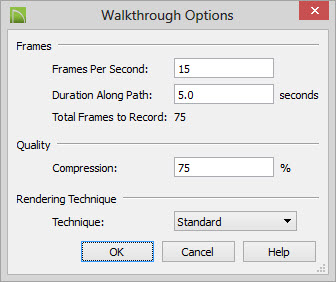

  5. In the Walkthrough Options dialog:
    • Specify the desired number of Frames Per Second, between 1 and 100. A higher number results in a higher quality recording but also a larger .avi file.
    • Specify a Duration Along Path, in seconds.
    • The Total Frames to Record equals the Frames Per Second times the Duration along Path.
    • Specify a Compression percentage between 0 and 100. A value of 0 gives the highest quality images and largest file sizes.
    • From the drop-down list, select the Rendering Technique you would like the walkthrough to use.
    • Click OK.
