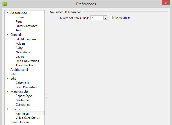

If you would like to change whether the CPU allocation is for Ray Tracing, or Chief Architect, this setting can be controlled in Preferences.
To optimize for Chief Architect
  1. Before ray tracing, within your plan, select Edit> Preferences .
    Chief Architect> Preferences for a Mac.
    Note: If you change this setting when there are already ray traces in progress or queued, they will not be affected.  Only ray traces that you start in the future will be controlled by this setting.
  2. In the category list select Ray Trace, you can then raise or lower the Number of Cores Used, or check Use Maximum to use all available cores.
  3. When you have set the desired number, click OK.

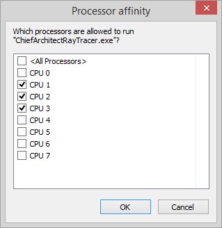

While still in the Task Manager, you can also choose which processors run the ray tracer.
To control which processors run the Chief Architect ray tracer
  1. Again right click on the ChiefArchitectRayTracer.exe and this time, select Set Affinity.
  2. In the Processor Affinity dialog, select which processors are allowed to run the ChiefArchitectRayTracer.exe, then click OK.
