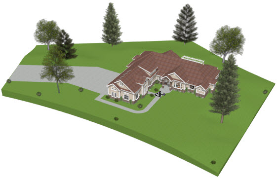

In some cases, such as if you have an oblong lot with the house not located in the center, then you may not want the focal point of your overview camera to be in the middle of the terrain.
Instead, you may want it to be at the actual structure. You can either change the focal point of the camera in floor plan view, or there is also a tool that will allow you to do this while still having the Overview active.
To change the focal point in the Overview
  1. While in the Overview, select 3D> Move Camera with Mouse> 3D Center Camera on Point .
  2. Click on any object in the overview to move the focal point to that location.
  3. In addition to controlling how it will spin, this also sets the camera center so that future use of Mouse-Orbit Camera tool rotates around that point.
