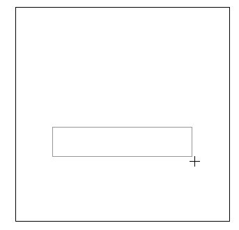

  1. If you haven't already created a terrain perimeter within your plan, do so now by going up to Terrain> Create Terrain Perimeter
  2. Next, select Terrain> Driveway> Straight Driveway  from the menu, then click and drag to draw a rectangular terrain feature.
  3. Do not worry about the exact placement or shape of the driveway as you draw it: once it is created, it is fully editable.

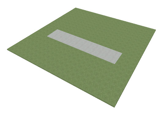

  5. By default, driveways are assigned a grey concrete material.  If you want to, you can select 3D> Material Painter> Material Painter  from the menu to apply a new material.

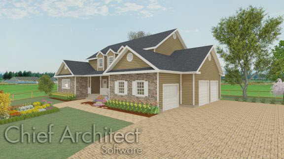

    • Good candidates for driveway materials can be found in the Masonry & Stone and Landscaping categories. Brick, pavers and slate are among the textures that work well to represent stamped concrete.
    • When you have found a material, click on it to select it, then click the OK button to close the dialog.
    • In this example, Landscaping> Pavers> Basketweave Brick is used.

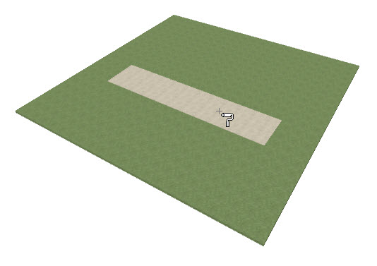

  4. When you move your cursor into the 3D view, it will display a paint roller icon.
    Click on the driveway to apply the selected material to its surface. Instead of replacing the pavers material with the solid color, the two are blended.

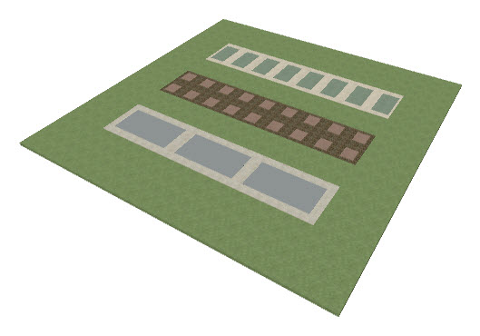

A wide variety of driveway designs can be created by combining stamped patterns and stains. You can produce your own unique design using multiple driveway objects.

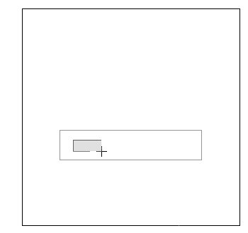

  2. Select Terrain> Driveway> Straight Driveway  from the menu, then click and drag a second driveway object inside the first.
  3. Select this second driveway and click the Open Object  edit button.
  4. On the General panel of the Driveway Specification dialog, specify the Height as 1 1/16", then click OK. This will raise the top surface of this object above that of the larger Driveway so it can be clearly seen.

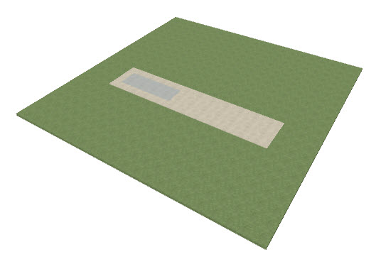

  6. Use the Material Painter  and/or Blend Colors with Materials  tools to apply a custom material to this driveway object.
  7. Just as in floor plan view, you can edit the shape and position of the second Driveway in a 3D view using its edit handles.
  8. Repeat steps 1 through 5 as needed to create a custom pattern.
