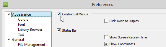

  1. To enable your contextual menus, select Edit> Preferences  if you're using a Windows PC or Chief Architect> Preferences  if you're using a Mac.
  2. In the list on the left side of the Preferences dialog, click on the Appearance panel.
  3. Place a checkmark in the Contextual Menus checkbox.
  4. Depending on your work style, you may also wish to check the box beside Click Twice to Display, which requires two right-clicks to display contextual menus instead of one click.
  5. Click the OK button to close the dialog and enable contextual menus in all plan and layout files, and in all views. Contextual menus display when we right-click on:

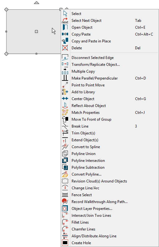

    • CAD objects, such as the polyline below:

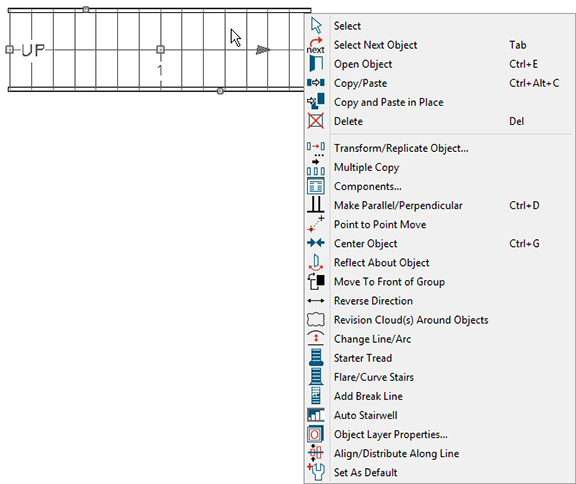

    • Architectural object, such as these stairs:
