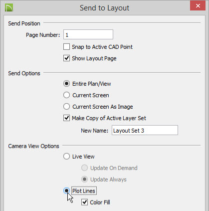

To send a view to layout using Plot Lines
  1. When you send a Cross Section/Elevation View, Camera View, or Overview using the Vector View rendering technique to your layout, in the Send to Layout dialog, under Camera View Options, select Plot Lines and then click OK. This prevents the view from being dynamically linked to your plan or view.
  2. To change a view that has already been sent to layout to use Plot Lines, select the view and then click the Open Object  edit button. On the General panel, under Camera View Options, select Plot Lines and then click OK.
