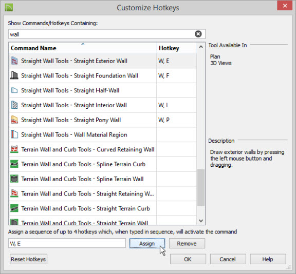

  1. With a plan file open, select Tools> Toolbars and Hotkeys> Customize Hotkeys  to open the Customize Hotkeys dialog.
  2. Use the Show Commands/Hotkeys Containing field to search for the command to assign a sequence of hotkeys to and select it.
  3. Click in the text field at the bottom of this dialog, type the sequence of keys you want to use to activate this command, and then click Assign.
    Note: To assign sequential hotkeys, do not hold down the keys at the same time, but instead click each key in the sequence you wish to assign to the command. Holding down the keys at the same time will create a multi-key hotkey. For information on creating multi-key hotkeys, please see the Related Articles section at the bottom of this page.
  4. If the command already has a sequence of hotkeys assigned to it that needs to change, click Remove, and then continue with step 3.
  5. The Reset Hotkeys button can be used to revert all assigned hotkey sequences to those that ship with Chief Architect.
  6. After assigning hotkeys, click OK to close the Customize Hotkeys dialog.
