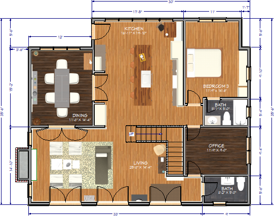

I want to create a brochure/flyer or post a portfolio of my plans on my website with some nice floor plan images. How can I create a 2D plan view with some rendered 3D characteristics like flooring, furniture, and appliances?
You can overlay a 2D and 3D view by utilizing the layout feature.
One technique for creating the image above is to overlay a floor plan view on top of a camera view.
To create the top down view displaying textures

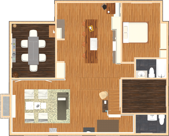

  1. With your plan open, select 3D> Create Orthographic View> Orthographic Floor Overview  to create a 3D camera view of your structure.
  2. Navigate to 3D> View Direction> Top View to reorient the view facing downward.
    Take an Orthographic Floor Overview of your design.
  3. Navigate to 3D> Rendering Techniques> Standard to change the rendering technique and show the material textures in the view.
    In X16 and newer versions, a toggle-able Display Poché option is available in your views. To enable this, go to Tools> Active View> Edit Active View and enable the Display Poché setting. For more information, please see the Related Articles section.
    In your Orthographic Floor Overview, change your Rendering Technique to Standard.

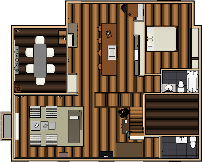

  4. Select Tools> Layer Settings> Display Options  or use the Active Layer Display Options  to remove any checkmarks from the Display column for layers you don't want to see in the view.
Once everything is displayed to your liking, you are ready to send the camera view as well as the floor plan view to a layout.

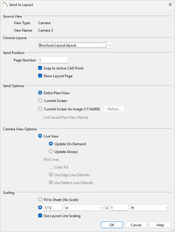

To send the top down view and a floor plan view to layout
  1. With the 3D camera view exactly how you want it, navigate to File> Send to Layout  from the menu.
  2. Specify any options here, such as the Layout you'd like to send it to, the Page Number, and the Scaling, then click OK.
    In the Send to Layout dialog, specify your desired scale.

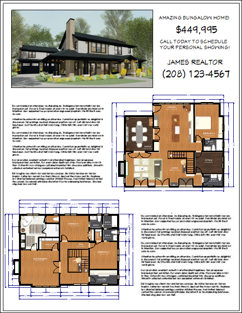

  5. Use the Move  edit handle along with the Point to Point Move  tool to move the floor plan so it's aligned with the 3D camera view.
    Algin your 2D and 3D view to create an overlay.
    You may want to adjust the draw order of your floor plan or camera view on your layout. For information on adjusting the draw order of objects, please see your program's Help documentation.
  6. Now you can continue to send views over to this layout file and Print  it out, or you can export it by going to File> Export> Export PDF  or File> Export> Export Picture .
    Once finished you can export or print your brochure page.
