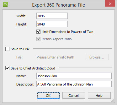

  3. In the Export 360 Panorama File dialog that opens, check the Save to Chief Architect Cloud box, select the Create New or Replace Existing radio button, supply a Name and an optional Description, then click OK.
    If you selected the Replace Existing option, you must click the Browse button and choose an existing panorama to replace/overwrite.
    Export 360 Panorama File dialog where width, height, and save options are listed
    You can also specify the Width and Height, in pixels, as well as choose to save the panorama to disk or save it as a backdrop. To learn more, please access your program's Help documentation.

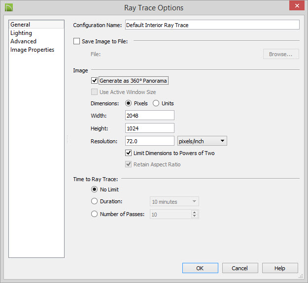

  4. On the General panel of the CPU Ray Trace Options dialog. check the Generate as 360° Panorama box, specify the Dimensions and Resolution of the image, as well as any other ray trace options that are desired, then click OK
    Generate as 360° Panorama box checked on the General panel of the Ray Trace Options dialog

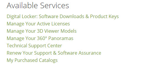

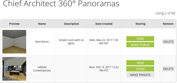

  1. Sign in to your Chief Architect Account using a web browser, then click on Manage 360° Panoramas.
    You may notice an "Upload Panorama" button here; this allows you to upload 360° panorama files that may have been saved to your local computer, directly to the Chief Architect Cloud.
  2. Click the View button next to your 360° panorama to view it in your web browser.
  3. If at anytime you want to remove or deactivate a 360° panorama from your account, check the box next to the Name of the model, then click Deactivate Panoramas. Click Yes to confirm the deactivation and removal of the panorama.
  4. Panoramas are private by default. A panorama needs to be made public before it can be shared or embedded. Click the Make Public button to enable sharing.
    Selecting the Make Public button for a 360° Panorama
    To make a 360° panorama private, click on the Make Private button. Any users that had access to the panorama lose access immediately and any open instances of the panorama will be closed.

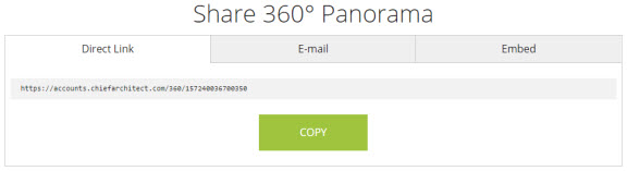

    • Direct Link
      Click the Direct Link tab to directly share your Panorama. Copy the link and paste it to wherever you're sharing it.

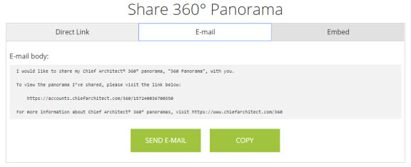

    • E-mail
      Select the E-mail tab. Click the Send E-mail button to open the default mail application on your computer (Outlook, Microsoft Mail, macOS Mail, etc.). Click the copy button if your primary e-mail is a web-based e-mail (Gmail.com, Outlook.com, Yahoo.com, etc.). This will copy the text to your clipboard. Go to your web based e-mail client and start a new e-mail. Then paste the text to add it to your new e-mail.

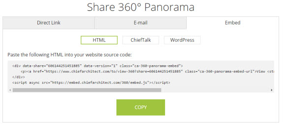

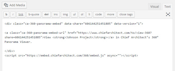

    • Embed
      Click on the Embed tab, copy the HTML code, and paste it into the source code for your website; or provide the code to your webmaster and ask them to add it to your website.
