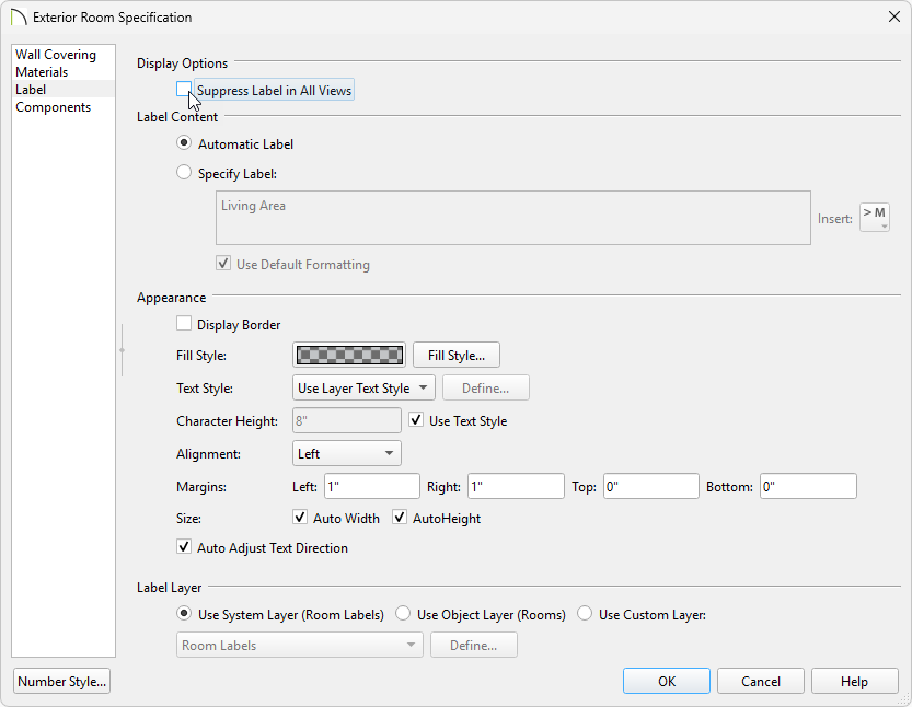

  2. With the Exterior room selected use the Open Object  edit tool to open the Exterior Room Specification.
  3. In the Exterior Room Specification, navigate to the Label panel, uncheck Suppress Label in All Views, and click OK.
    Alternatively, with the Exterior Room selected, use the Display Label In This View edit tool to re-enable the Living Area label.

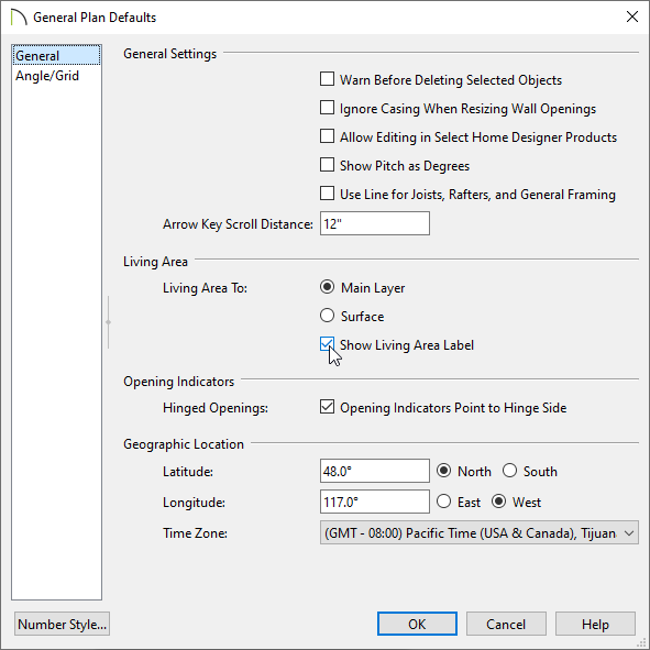

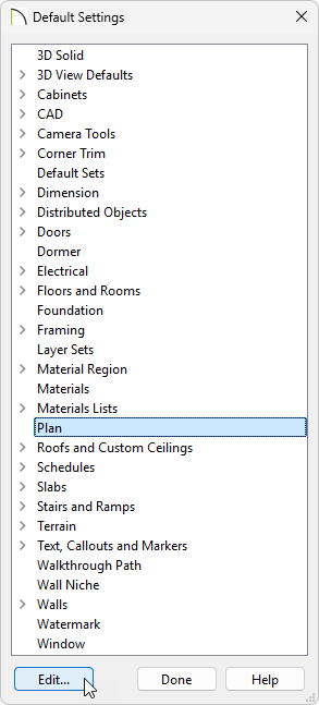

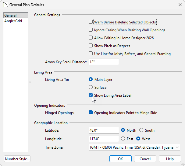

    Note: You can also find a Suppress Living Area Label setting in your General Plan Defaults. These defaults can be accessed by going to Edit> Default Settings> Plan and clicking Edit.
    This Suppress Living Area Label setting will only affect newly created areas. The Living Area Label will not be brought back by unchecking this option.
    Uncheck Suppress Label in All Views and click OK.

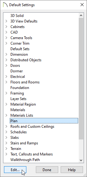

  1. Select Edit> Default Settings  from the menu.
  2. In the Default Settings dialog, select Plan from the list, then click Edit.

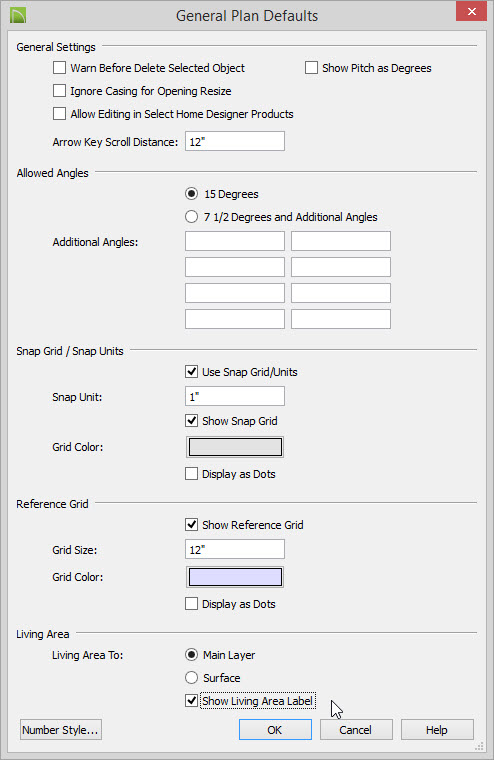

  3. In the General Plan Defaults dialog that displays, place a check in the Show Living Area Label box.
    Default Settings with Plan selected
  4. Click OK and Done to confirm the changes and close the dialogs.
