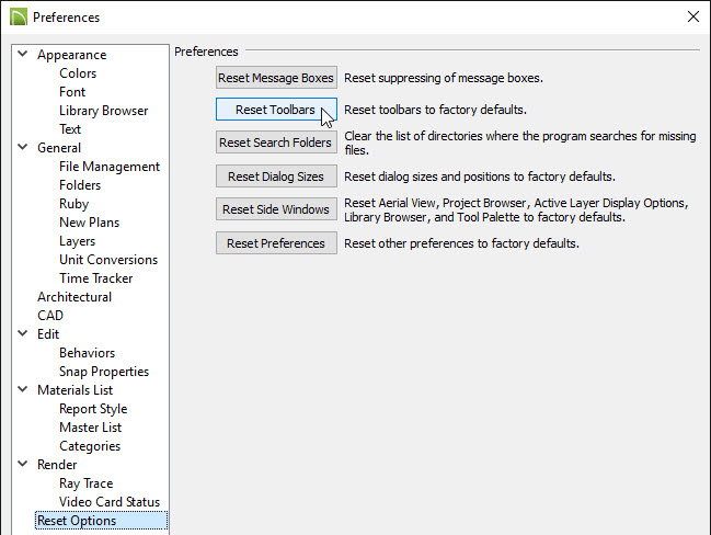

  1. Select Edit> Preferences if you're on Windows PC or Chief Architect/Home Designer> Preferences if you're on a Mac to open the Preferences dialog.
  2. Select the Reset Options panel on the left and then click on the Reset Toolbars button.
