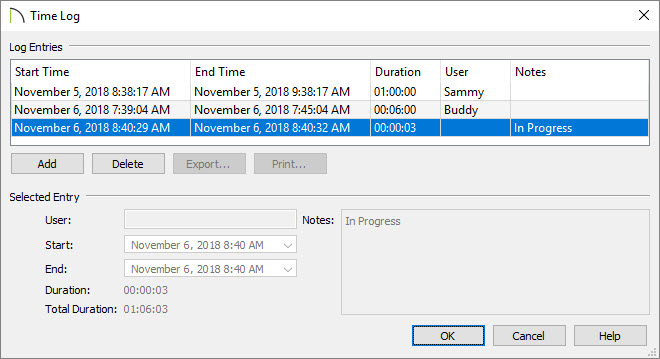

    Viewing the time log

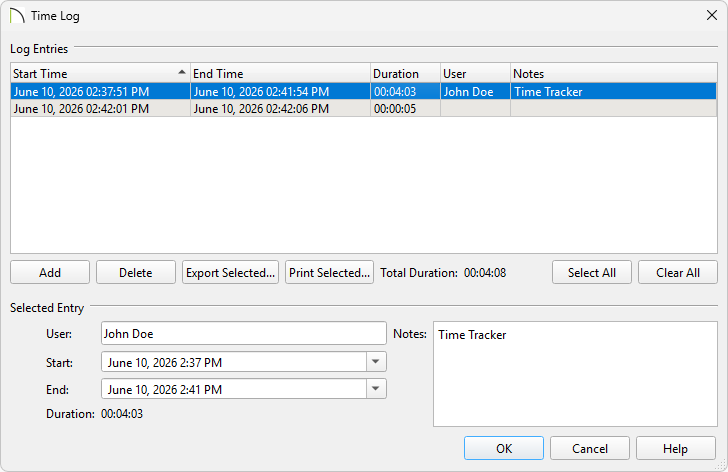

  5. In the Time Log dialog, click on an entry to select it, then edit its properties, as needed.
    Note: In X18 and newer, you can sort entries by clicking on the column heading (Start and End Time, Duration, User, and Notes).
    • The User that created each entry, or worked on the project at the given time, can be specified.
    • The Start and End times can be edited by typing new values in these fields. You can use the drop-down list and select a date from the calendar. The Start time must predate the End time.
    • Notes about the selected entry can be typed into the text field on the right.
    • The Export Selected button allows you to save the selected time entries and the total duration as either a text (.txt) or Comma Separated Values (.csv) file.
    • The Print Selected button allows you to print the selected entries and total duration.
  6. Click the Add button to add a new entry below the currently selected entry, which will use the current time as the Start Time.
  7. Click the Delete button to delete selected entries.
  8. Use the Select All and Clear All buttons to select or deselect all of the entries in the table for the purposes of exporting, printing or deleting.
