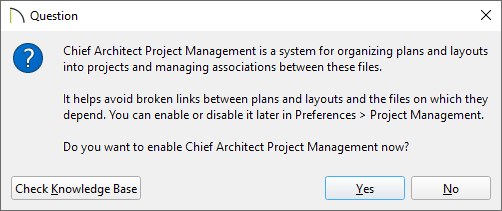

I receive the following question when opening X17, Home Designer 2026, or a newer version for the first time:
Question dialog asking if you want to enable Project Management.
Should I enable this feature?
OR
How do I enable or disable Project Management, or switch back and forth between the two at any time?

If you are prompted with the question at the beginning of this article, click Yes to enable this functionality, or No to continue using Traditional File Management.

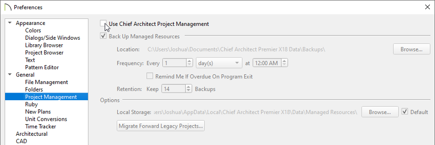

To enable or disable Project Management
  1. Select Edit> Preferences  if you're on a Windows computer or Chief Architect/Home Designer> Preferences if you're on a Mac.
  2. On the Project Management panel of the Preferences dialog, check or uncheck the Use Chief Architect Project Management box, then click OK.
    In order to change between Project Management and Traditional File Management, all plan and layout files must be closed.
    Check or uncheck the Use Project Management box
  3. A Preparing Settings dialog will appear. Once this dialog disappears, you can begin working.
