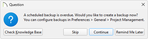

By default, scheduled backups are enabled and are set to take place every day at 12:00 AM (Midnight). If the program is not open at the scheduled time, you may be prompted with a Question dialog asking "A scheduled backup is overdue. Would you like to create a backup now?..." the next time you open and close the program. You can choose Skip to skip this particular backup, Continue to proceed with performing the backup, or Remind Me Later to have Chief Architect remind you to perform this backup at a later point
Question dialog stating a scheduled backup is overdue

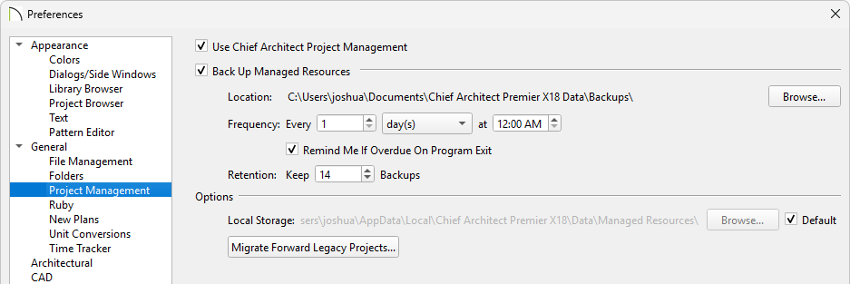

Settings related to scheduled backups can be controlled within the Preferences dialog. Navigate to Edit> Preferences  if you're on a Windows computer or Chief Architect/Home Designer> Preferences  if you're on a Mac. Once here, navigate to the Project Management panel.
Project Management panel in Preferences
  • To enable/disable scheduled backups, you can check or uncheck the Back Up Managed Resources box.
  • The Location where backups are saved on the local system is reported here. By default, it is located in the Chief Architect/Home Designer Data folder; however, you can click the Browse button to select a different location.
  • Set the Frequency at which backups are created by specifying an interval value of either Hours or Days and choosing a time of day.
  • Check or uncheck the Remind Me If Overdue On Program Exit* box to control the Question box mentioned above.
  • Specify the Retention of backups, which is the maximum number of saved backups. Once this value is reached, the oldest backups are deleted from the system.
  • The Local Storage location of the Managed Resources is located here. Although not recommended, the option to uncheck the Default box and click the Browse button to specify a different location is available.
  • The Migrate Forward Legacy Project* button allows projects associated with a prior version's Managed Resources to be migrated into the current version.

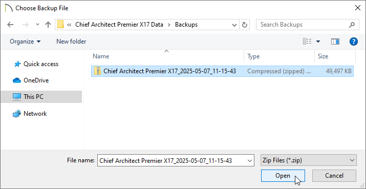

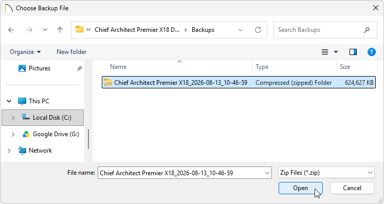

To use the Restore from Backup tool
  1. Close out of all plan and layout files, then navigate to File> Back Up and Restore> Restore from Backup .
  2. Select a backup, which will be a compressed (zipped) folder with the name of the program, followed by the date, then click Open.
    Choose Backup File dialog with a backup selected
