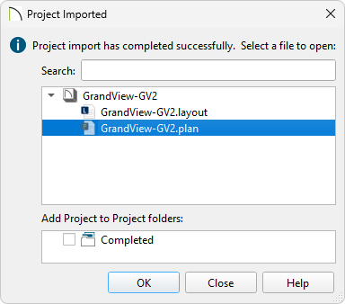

  8. Upon performing the import process, the Project Imported dialog will open and state "Project import has completed successfully. Select a file to open:". You can choose to either open one of the files within the project or click Close at this time.
    Project Imported dialog displaying the files that were imported
    All plan and layout files associated with the imported project will now be listed in the Project Browser , while any referenced asset files will be listed in the Asset Management dialog.

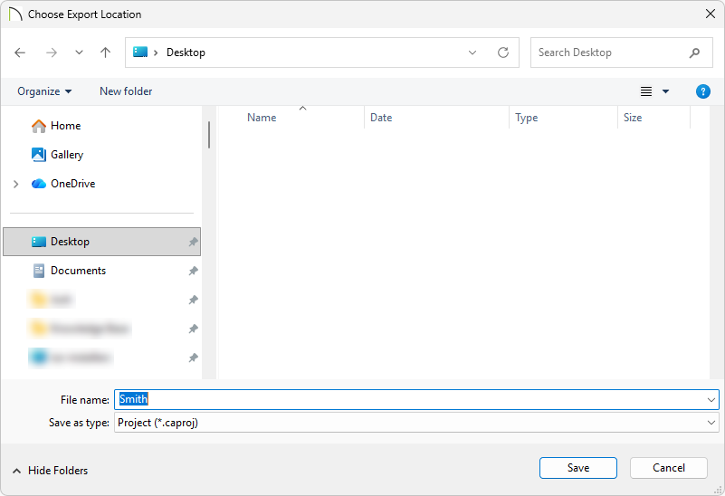

  1. In X17, Home Designer 2026, and newer, navigate to File> Export> Export Plan/Layout as Project , and in the dialog that appears:
    Choose Expore Location dialog where a file name can be specified
    • Choose a desired location and a File name, then click Save.
    • An Information dialog will appear stating "Project export is complete. [#] plan file and [#] layout file were saved." Click OK.
