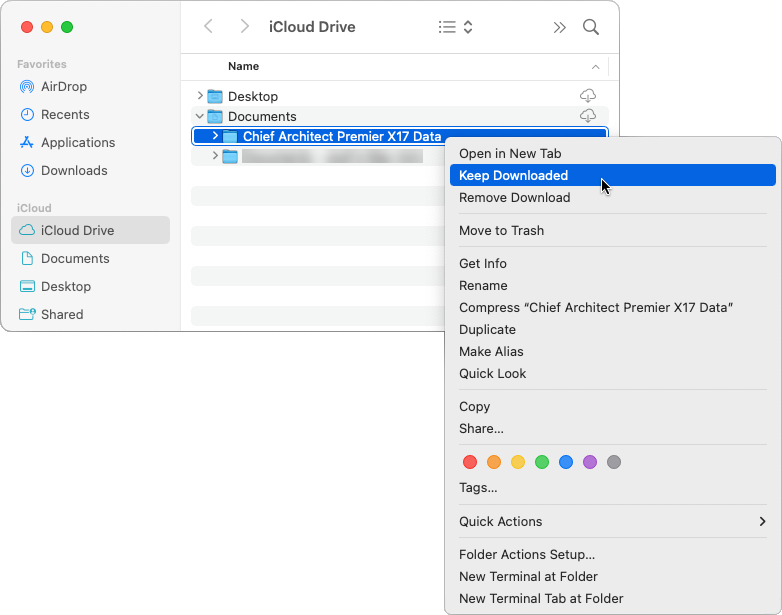

Keeping the Data folder downloaded
The following steps apply to systems running macOS Sequoia (15) and newer.

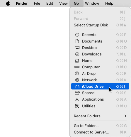

  1. Open the Finder app or click once in an open area on the Desktop to make Finder the active application.
  2. From the menu bar, click Go> iCloud Drive.
    Navigate to Go> iCloud Drive from the menu bar
  3. Open the Documents folder in iCloud Drive.
  4. Right-click on the Data folder, then click Keep Downloaded.
    Hold down the Control key while clicking to initiate a right-click command. More information about right-click commands on Apple input devices can be found in the following Apple resource: Right-click on Mac.
    Note: Depending on the size of the Data folder and your internet speed, it may take some time for its contents to finish downloading.
    Right-click on the Data folder and choose Keep Downloaded

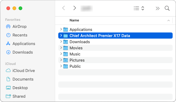

Creating a local Data folder
In macOS Sonoma (14) and prior, files synced to iCloud Drive don't have the option to stay downloaded. Instead, you will need to create a Data folder outside of Documents and iCloud Drive to prevent the behavior and issues mentioned above from occurring. In this example, we will be using the Home/User folder. The new folder must then be mapped within the Chief Architect program's Preferences, which is discussed in the next section.

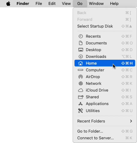

  2. From the menu bar, click Go> Home.
    Selecting Home in Go menu
  3. From the menu bar, click File> New Folder.
    The name of the new folder will be your program version with the first letter of each word capitalized, followed by the word "Data". In this example, a Data folder is created for Chief Architect Premier X17, so the folder name is: Chief Architect Premier X17 Data
    Newly created Data folder in Finder window

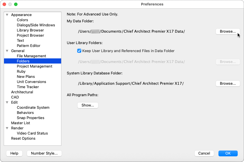

Specifying the location of the Data folder in Preferences
  1. Open Chief Architect or Home Designer. From the menu bar, click Chief Architect/Home Designer> Preferences .
  2. On the Folders panel of the Preferences dialog:
    Folders panel of Preferences dialog
    Edit Data Folder path in Preferences
    • Click Browse to the right of the My Data Folder file path and select the new Data folder that was created in the section above.
      If the Data folder was placed in the Home/User folder, the file path after selecting the new Data folder will be: /Users/username/Chief Architect Premier X17 Data/
    • After specifying the correct folder location, click OK.
