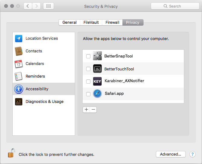

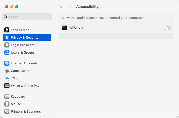

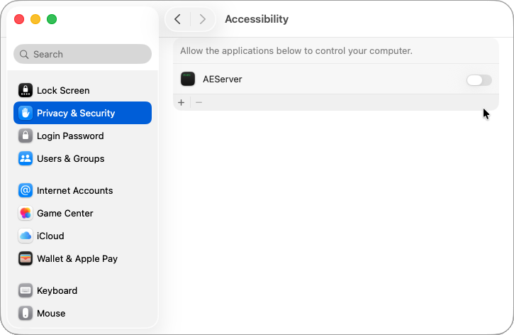

Step 5 - Modify Accessibility Settings
The most common conflicts that we have recorded have to do with software that modifies the Accessibility settings of the Mac.
To troubleshoot if this is the case, first Save your work then close out of the Chief Architect software if you have it open.
Select the Apple menu, access System Settings, select the Privacy & Security category, then click on the Accessibility subcategory.
If any applications in this list are allowed to control your computer, disable them.
Accessibility section located on the Privacy tab of Security & Privacy
Note: You may need to provide your user account password to make changes in this section.
If you're unable to disable an application in this section, you may be using macOS Monterey 12 or prior and will need to click on the padlock icon in the lower left corner before you can make changes.
