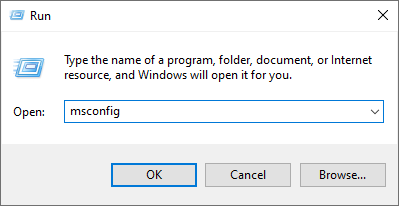

  2. Press: Windows  + R to open the Run dialog.
  3. Type: msconfig , then click OK.
    Type msconfig in the Run dialog, then click OK

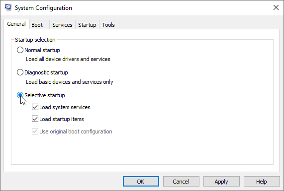

  4. In the System Configuration dialog that displays next:
    Selective startup option selected
    • On the General tab, select the Select startup radio button.
    • Select the Services tab, check the Hide all Microsoft services box at the bottom, then click the Disable All button.
    • Click Apply, then OK, and proceed to Restart the system.
Once the system has restarted, launch the Chief Architect program, and test to see whether the behavior still occurs. If the issue no longer occurs, there is likely a conflict with a third party application running on your system; one known application that causes conflicts with Chief Architect programs is Nahimic Audio, which can be uninstalled.
After the cause is determined, it is important to navigate back in to the System Configuration dialog and revert back to the Normal startup option located on the General tab. If a cause can't be determined using this process, ensure that you have restarted your system using the Normal startup option before proceeding to the next section in this article.
