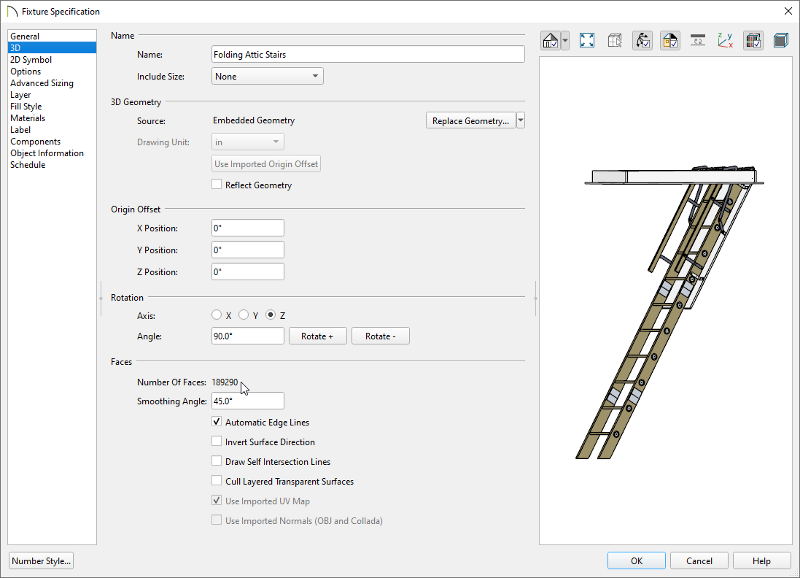

  • Manage 3D Surface Count - Avoid importing 3D objects from outside sources that have a large number of complex surfaces, as these can significantly slow down camera views.
    To check the number of surfaces for imported symbols, click on an imported symbol using the Select Objects  tool, then click on the Open Object  edit tool. On the 3D panel, take note of the Number Of Faces and then Cancel out of the dialog without making any changes.
    If you aren't certain whether or not a symbol has an unusually high number of faces, you may want to repeat this procedure on a similar type symbol placed from the Chief Architect catalogs and compare the Number Of Faces.
    The 3D panel located in the Object/Symbol Specification dialog lists the Number Of Faces for a symbol

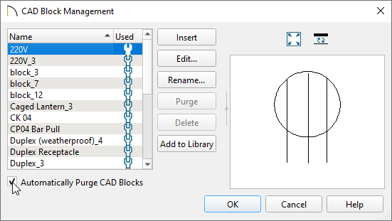

  • To purge unused CAD blocks, select CAD> CAD Block Management  from the menu. In the CAD Block Management dialog, there is a list of all CAD blocks referenced in your file.
    • Click the Purge button to delete any unused block definitions from the list.
    • You can also click on an unused CAD block in the list, then click Delete to remove it from the list.
    • Check the Automatically Purge CAD Blocks box to prevent unused CAD block definitions from being saved in the file.
    • When you're done making changes, click OK to close the dialog and apply the changes, then Save the file.
    Note: It is not possible to delete all CAD block definitions from a plan file. Even if no objects are present in the plan, the CAD blocks associated with default electrical symbols are saved with the plan and cannot be removed.

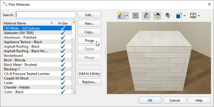

  • To purge unused materials from your plan, select 3D> Materials> Plan Materials  from the menu to display the Plan Materials dialog. The list on the left includes all materials present in the plan.
    Plan Materials dialog where unused materials can be purged
    • Click the Purge button on the right to remove any unused materials from the list.
    • You can also select an individual unused material from the list and click the Delete button.

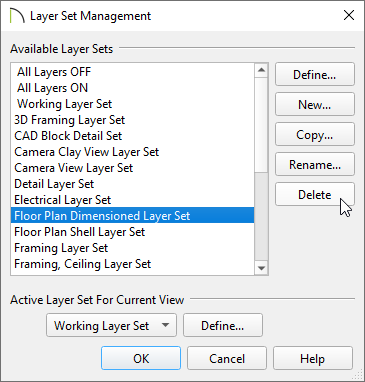

  • To manage layer sets, select Tools> Layer Settings> Layer Set Management  to open the Layer Set Management dialog. Use the Available Layer Sets options to manage the layer sets saved with the current plan or layout file.
    Layer Set Management dialog where layer sets can be deleted
    • Click the Delete button to delete a selected layer set from the current file.
      The Delete button is only enabled if the layer set can be deleted.
      Do not delete layer sets that are used in views that were previously sent to a layout file.
