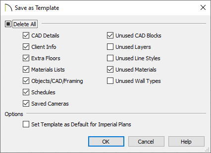

  2. Determine what items you would like to keep in the template and de-select those boxes.
    In the Save as Plan Template dialog choose what you'd like to delete.

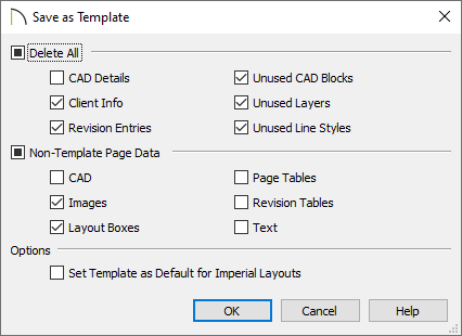

    For layout files, Non-Template Page Data can also be deleted.
    In the Save as Layout Template dialog choose what you'd like to delete.
    For more information on each of these options, click the Help button at the bottom of the dialog to open your program's Documentation.
  3. Check the Set Template as Default for Imperial/Metric Plans/Layouts box if you would like this file to be the default template when you create a New Plan / New Layout .
