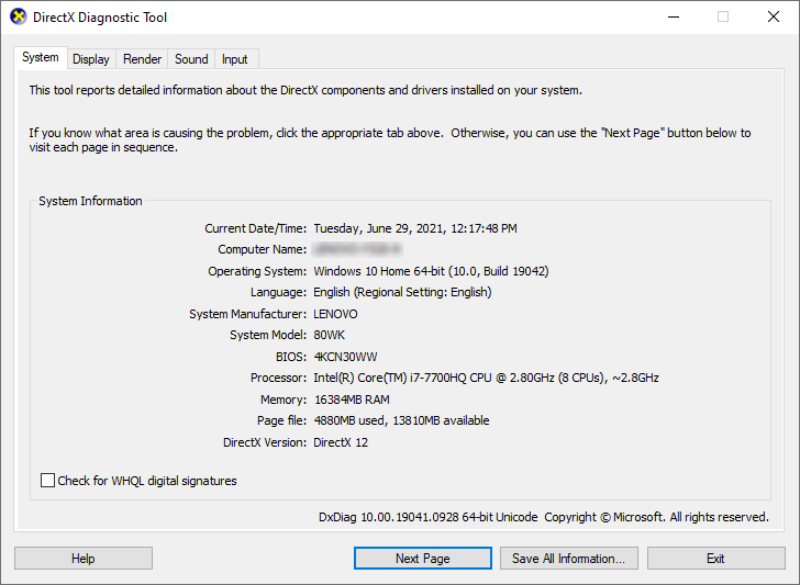

  3. The DirectX Diagnostic Tool dialog will appear. On the System tab, the Operating System, System Manufacturer, System Model, Processor, and Memory will be listed.
    System tab of the DirectX Diagnostic Tool

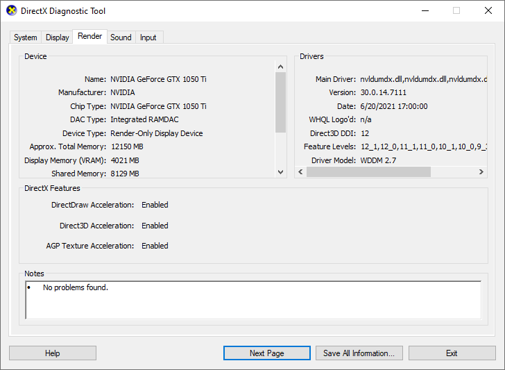

  4. On the Display tab(s), the graphics device will be listed in the Device section, while the driver information will be listed in the Drivers section on the right. If your computer has more than one graphics card, such as in the case where you have integrated and dedicated graphics, you may see an additional Render tab with graphics device information, like shown in the image below.
    Note: To view a complete list of Intel graphics models that the current version of Chief Architect products are compatible with, please see the Related Articles section below.
    The latest graphics driver is recommended for optimal performance.
    The Display and Render tabs show the video cards that the computer may have
    If you're experiencing a graphics or video card related error message or are unable to generate optimal 3D camera views, it's possible that your graphics card is not supported, the display driver installed is in need of an update, or there is a compatibility issue with your particular graphics card model. Please ensure that your graphics card meets the system requirements and proceed to follow the steps in the appropriate troubleshooting article linked in the Related Articles section below.
