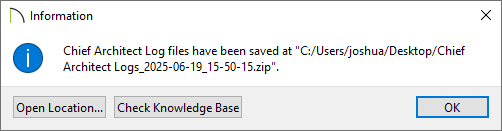

  3. An Information dialog will display with the location the logs have been saved to; click Open Location or OK.
    Note: When performing this action, all of the log files are exported to a single compressed (zipped) folder.

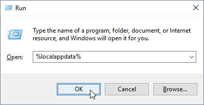

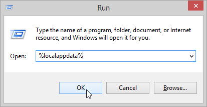

    • On Windows, press the Windows  key and the letter R at the same time, type %localappdata% in the dialog that appears, then press OK.

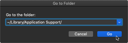

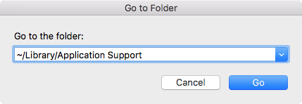

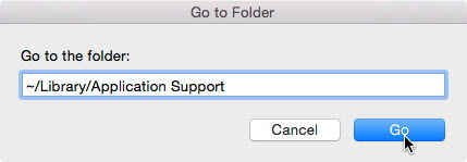

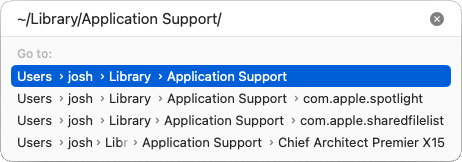

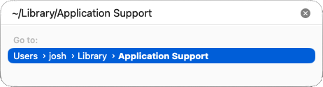

    • On macOS, select Go> Go to folder using Finder, type ~/Library/Application Support, then press Return or Go.
      Go to Folder dialog with ~/Library/Application Support/ in the field
  2. This will open a new File Explorer or Finder window on your system. Open the file folder corresponding to your product, and inside you will see a text file named Message Log.txt.
  3. Open the Message Log and select File> Save As from the menu, then save a copy of the log to your Desktop.
  4. The file can now be attached to a support case in the Technical Support Center
