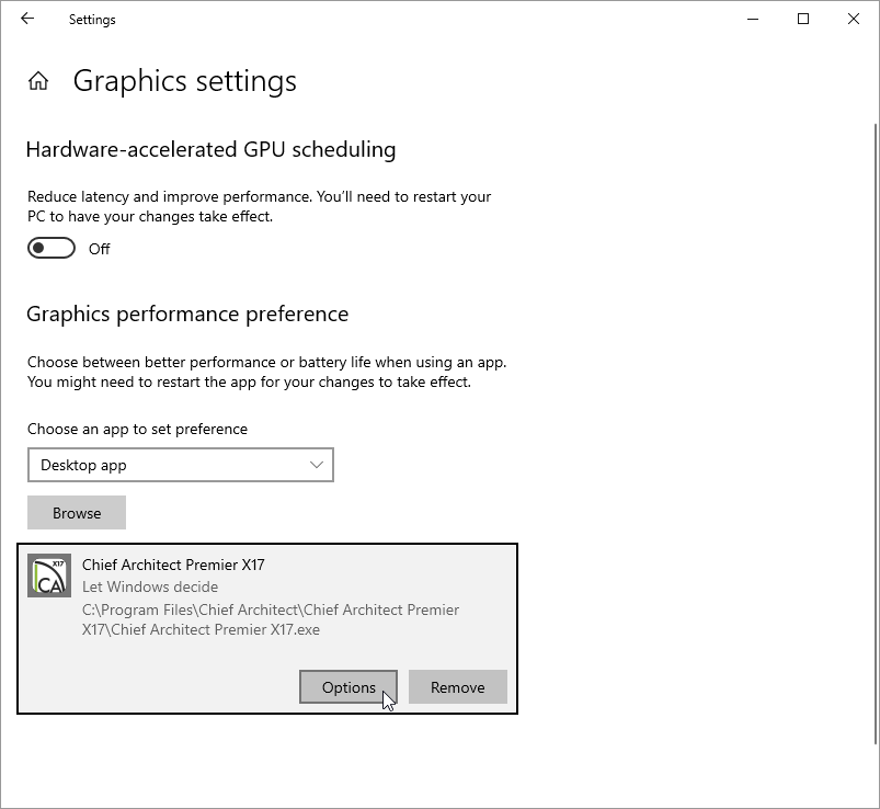

  4. In Windows 10, under the Choose an app to set preference heading, select Desktop app from the drop-down menu.
    In Windows 11, under the Add an app heading, select Desktop app from the drop-down menu.

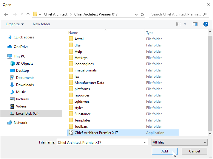

  5. Click the Browse button to open File Explorer. Browse to the Chief Architect or Home Designer executable file, select it, then click Add.
    By default, executable files for all Chief Architect programs are found in the following location: C:\Program Files\Chief Architect\ [PROGRAM TITLE AND VERSION].
    For example, the executable for Chief Architect Premier X17 is located in: C:\Program Files\Chief Architect\Chief Architect Premier X17.
    Selecting the Chief Architect executable file
    If you have installed a Chief Architect program to a different drive or location, refer to the location you have installed it to instead.
  6. With the desired Chief Architect program now listed, select it, then click the Options button.
    Select the program and click Options

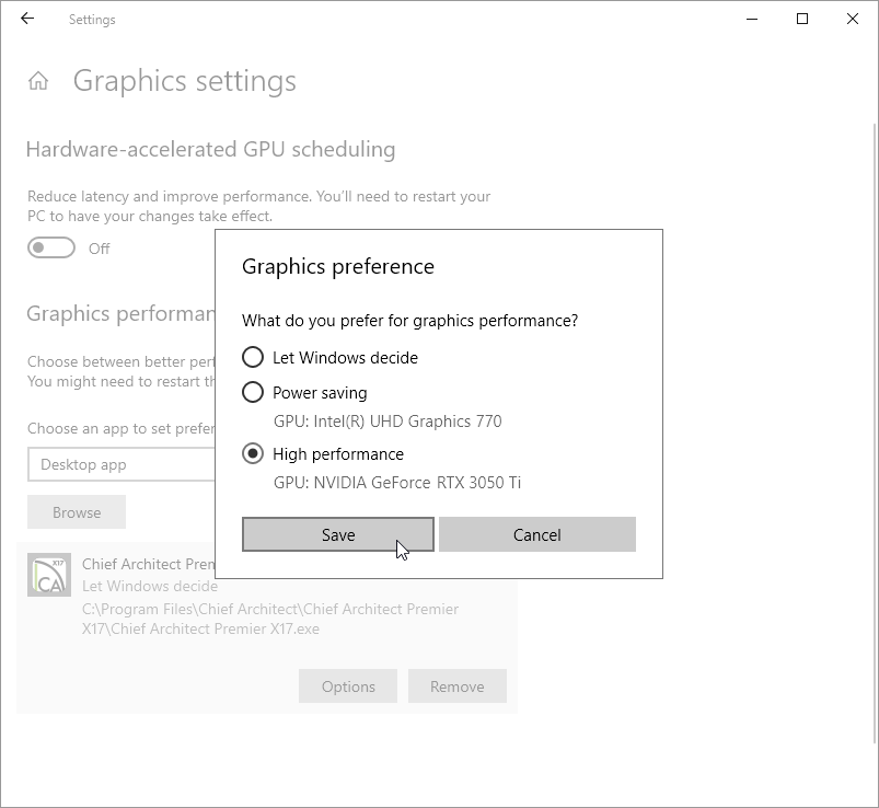

  7. Select the High performance option, then click Save.

  8. The high performance graphics card will now be utilized the next time you launch the Chief Architect program.
