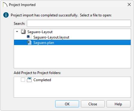

    • If you're using Project Management, various progress dialogs will display. Once imported, a Project Imported dialog will open and state "Project import has completed successfully. Select a file to open:". You can choose to either open one of the files within the project or click Close at this time.
      In Chief Architect X18 and newer versions, a project can also be added to a project folder at this time.
      Project Imported dialog stating the project has imported successfully
      All plan and layout files associated with the imported project will be listed in the Project Browser , while any assets will be listed in the Asset Management dialog.

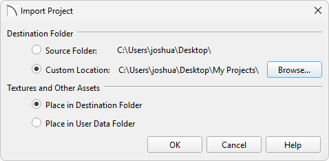

    • If you're using Traditional File Management, you will instead be prompted with an Import Project dialog, allowing you to choose the Destination Folder for the extracted project, and where you would like Textures and Other Assets to be placed. Once these settings have been specified, click OK.
      Import Project dialog that appears when importing projects when using Traditional File Management
      An Information message will display stating whether or not the project was successfully imported. Click OK to proceed without opening the files, or click Open file(s) from import to proceed with choosing a file to open.

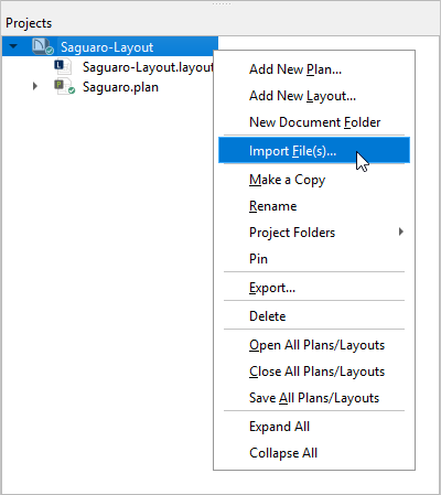

  1. You can import a variety of different files directly into a project using the Project Browser ; right-click on a project and select Import File(s).
    Note: On a Mac, hold down the Control key while clicking to initiate a right-click command. More information about right-click commands on Apple input devices can be found in the following Apple resource: Right-click on Mac.
    Right-click on a project in the Project Browser, then click Import Files from the contextual menu
  2. In the dialog that appears, select the file that you want to import, such as a plan, layout, image, PDF, etc., then click Open. The file will now be listed as its own line item within the project.
