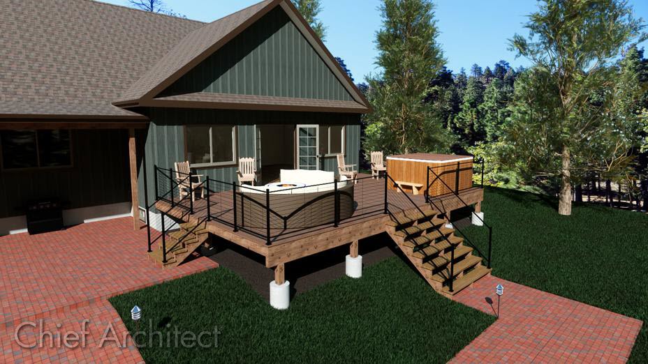

QUESTION
I need to create stairs that go from my deck and porch down to the ground. How do I do this?
Image of a deck with stairs leading down to the terrain
ANSWER
The Straight Stairs tool can be used to easily place stairs between levels on the same floor or between a floor platform and the terrain with a single click.
This article assumes that you have already drawn a deck or porch and have a Terrain Perimeter generated.
Using the Straight Stairs tool
  1. With the plan in which you need to create stairs from your deck or porch, select  Build> Stairs> Straight Stairs  from the menu.
  2. Left-click once just outside the deck railing on the same level as the terrain. This will generate a staircase from the edge of your deck or porch down to the level of your terrain.
