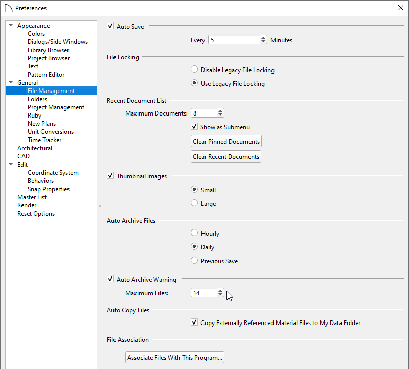

To control the Manage Archive prompt
  1. With the program open, select Edit> Preferences  if you're on a Windows PC or Chief Architect/Home Designer> Preferences  if you're on a Mac.
  2. Access the File Management panel within the Preferences dialog.
  3. Specify how many archive files should be created in the Maximum Files text field before this dialog displays.
    File Management panel of the Preferences dialog
    • The default value is 14.
    • If you would like to turn off this prompt completely, uncheck the Auto Archive Warning box.
      You can also specify whether Auto Archive Files are created Hourly, Daily, or by Previous Save here on this panel. The default option is Daily.
  4. Click OK to confirm your changes.
