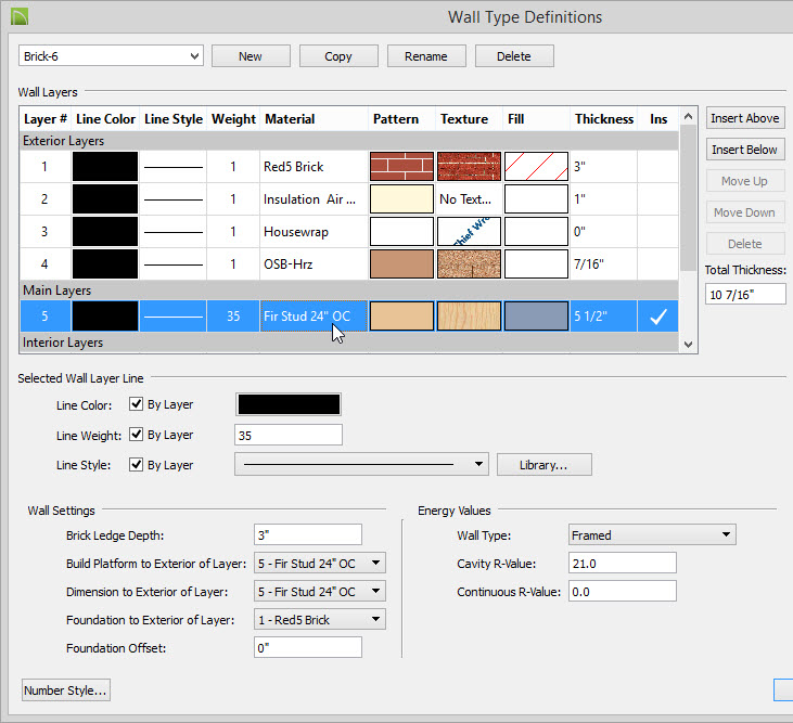

    Setting the on-center spacing for a framing wall layer
    1. Select Build> Wall> Define Wall Types  from the menu.
    2. In the Wall Type Definitions dialog, select your desired wall type using the drop-down menu in the top left corner, then select one of the wall type's framing layer(s) by clicking on it within the Wall Layers table.
      Wall Type Definitions to change the Stud Spacing
    3. If it's not already checked, check the Framing box located on the Material Properties tab in X15 and newer, or under the Material Layer section in X14 and prior.
      • Specify the desired Stud Spacing.
        In X13 and newer, select the Use Default Use Default tool icon icon if you would like the stud spacing of this wall layer to follow the default Stud Spacing value located in the Framing Defaults.
        In X12 and prior, these properties are part of the framing material that is chosen for the wall layer.
      • Other framing properties can also be specified here. For more information on these other fields, please see the Related Articles section below or refer to your program's documentation.
    4. Click OK to close the dialog.
    The next time you build wall framing in this plan, any walls using the wall type you just edited will use the stud spacing that you specified.
