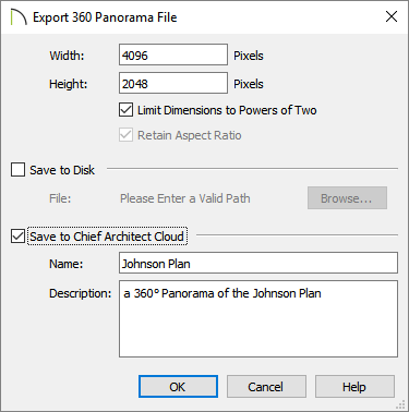

  3. In the Export 360 Panorama File dialog that opens, check the Save to Chief Architect Cloud box, select the Create New or Replace Existing radio button, supply a Name and an optional Description, then click OK.
    If you selected the Replace Existing option, you must click the Browse button and choose an existing panorama to replace/overwrite.
    Export 360 Panorama File dialog where width, height, and save options are listed
    You can also specify the Width and Height, in pixels, as well as choose to save the panorama to disk or save it as a backdrop. To learn more, please access your program's Help documentation.
