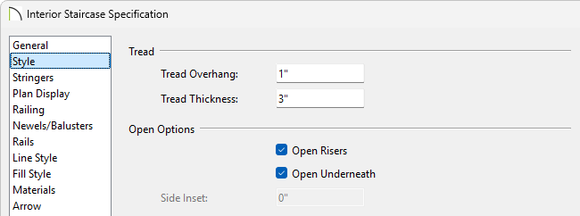

  3. In the Staircase Specification dialog that displays:
    Style panel of the Interior Staircase Specification dialog
    • On the Style panel, specify your desired Tread Overhang and Tread Thickness, then ensure that the Open Risers and Open Underneath boxes are both checked.
      In this example, the Tread Thickness is changed from the default value of 1" to 3".
