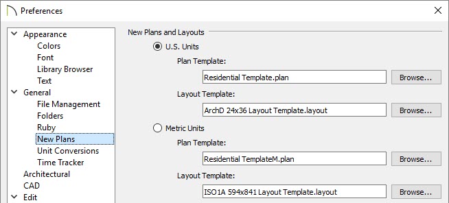

  1. Select Edit> Preferences  from the menu if you're on a Windows PC or Chief Architect> Preferences  if you're on a Mac.
  2. On the New Plans panel of the Preferences dialog, note the path-name of the Plan/Layout Template that is currently active.
    Select the New Plans panel of the Preferences dialog to specify the plana nd layout template
    • If this is referencing a project you finished in the past, you will want to select the Browse button to the right of the Plan/Layout Template fields and browse the Templates folder to select a different file.
      The default plan templates for Imperial, U.S. Units are the "Residential Template.plan" and "Kitchen and Bath Template.plan," while the default plan templates for Metric Units are the "Residential TemplateM.plan" and "Kitchen and Bath TemplateM.plan."
      The default layout template for Imperial, U.S. Units is the "ArchD 24x36 Layout Template.layout," while the default layout template for Metric Units is the "ISO1A 594x841 Layout Template.layout."
    • Once the templates are to your liking, click OK to confirm the change and close the dialog.
  3. Now, when you select New Plan or New Layout , the template that was specified will be used.
