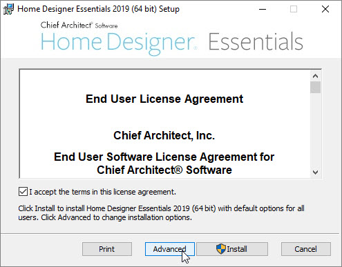

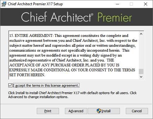

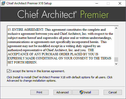

    • In Windows, the first window shows the End User License Agreement. Read this carefully and then check the I accept the terms in this license agreement box. Once this box is checked, select the Advanced button.
      Click the Advanced button in the Setup wizard after accepting the terms of the license agreement

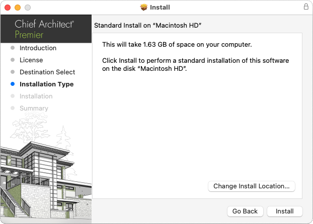

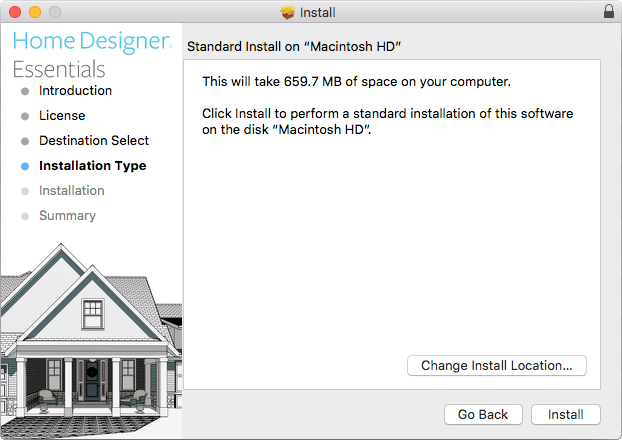

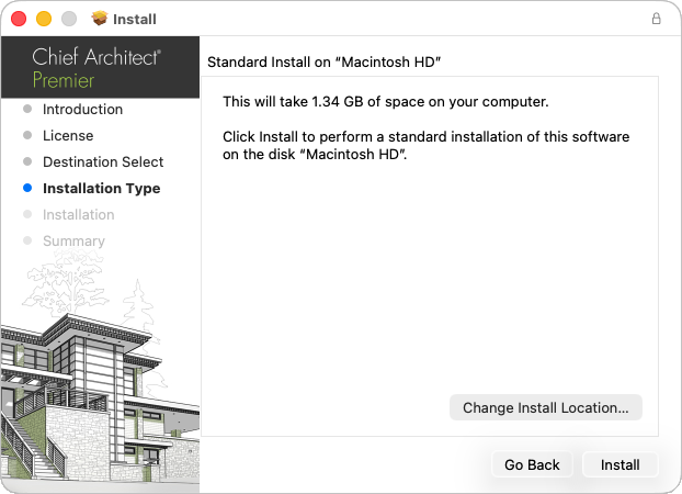

    • In macOS, the installer begins with the Welcome to the Installer screen. Click Continue. Read the End User License Agreement carefully, then click Continue and Agree. On the next screen, click the Change Install Location button.
      Select the Change Install Location button in the Install wizard
