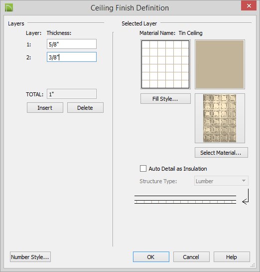

  4. In the Ceiling Finish Definition dialog that displays, change Layer 2 to a material of your choosing by clicking on the Material, Pattern, or Texture cell..
    Ceiling Finish Definition dialog box
  5. Set its Thickness, make any other adjustments, then click OK.

  3. In the Ceiling Finish Definition dialog that displays, change Layer 2 from the default material to the one of your choosing by clicking on the Material, Pattern, or Texture cell.
  4. Set its Thickness, make any other adjustments, then click OK.
