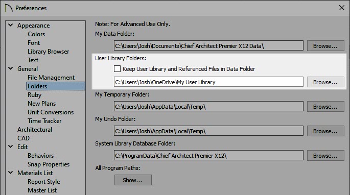

- Select the Folders panel, uncheck the Keep User Library and Referenced Files in Data Folder box, then click the Browse button next to User Library Folders.
- Choose the folder location that you would like to move your User Library to, then click on the Select Folder button.
In this example, the catalogs are going to be moved and hosted on Microsoft OneDrive.
- The User Library Folder should now show the new file path for the folder that you selected.
- Click OK to confirm the change and the dialog will close.

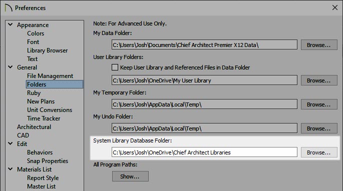

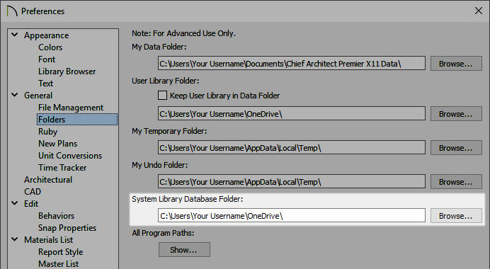

- Select the Folders panel and click on the Browse button next to System Library Database Folder.

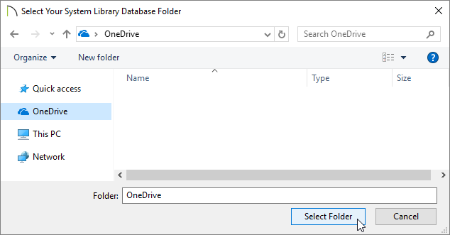

- Choose the folder location that you would like to move your library content to, and then click on the Select Folder button.

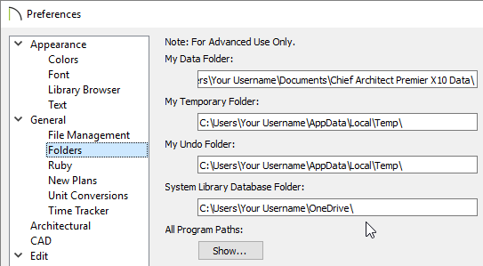

- The System Library Database Folder should now show the new file path for the folder that you selected.
