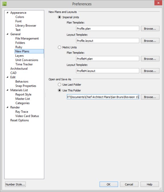

  1. Select Edit> Preferences  if you're on a Windows PC or Chief Architect/Home Designer> Preferences if you're on a Mac.
  2. Click on the New Plans panel, and under the Open and Save As section, two options are listed:
    New Plans panel of the Preferences dialog
    • Use Last Folder instructs the program to open the last directory or folder when Open Plan , Open Layout , and Save As  are used when using Traditional File Management, or when Open Plan/Layout  (unmanaged files) and New Project From Legacy Folder/Import Legacy Folder  are used when using Project Management.
    • Use This Folder instructs the program to open a specific folder, as specified by the user. When Use This Folder is selected, the path name field and Browse button become active to allow the user to either type or Browse to the location they wish to set.
  3. Click the Browse button to open the Select a Plans Folder dialog.
  4. Browse to the location on your computer where you would like Chief Architect to refer every time you select Open Plan , Open Layout  and Save As  when using Traditional File Management, or Open Plan/Layout  (unmanaged files) and New Project From Legacy Folder/Import Legacy Folder  when using Project Management.
  5. Click OK to close the dialog and apply your change.
