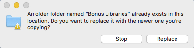

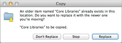

  7. If a folder with the same name exists in this location, a message will prompt you to either Replace the existing folder, Skip this folder and keep the existing one, or Stop the pasting process completely. Choose Replace to paste your backed up folder.

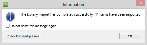

To restore the user catalog
  1. Launch the Chief Architect or Home Designer program and create a New Plan .
  2. In the newly created plan, navigate to Library> Import Library from the menu.
  3. Browse to the location where you saved the backup of your user catalog.
  4. Select the library (*.calibz or *.calib) file and click Open.
  5. Once imported, an Information message will display saying that the library has been imported successfully. Click OK.
    Information dialog that mentions the library has completed successfully
