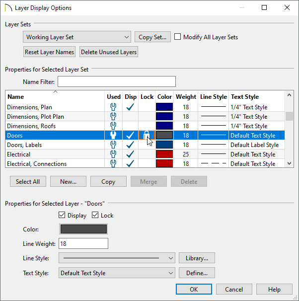

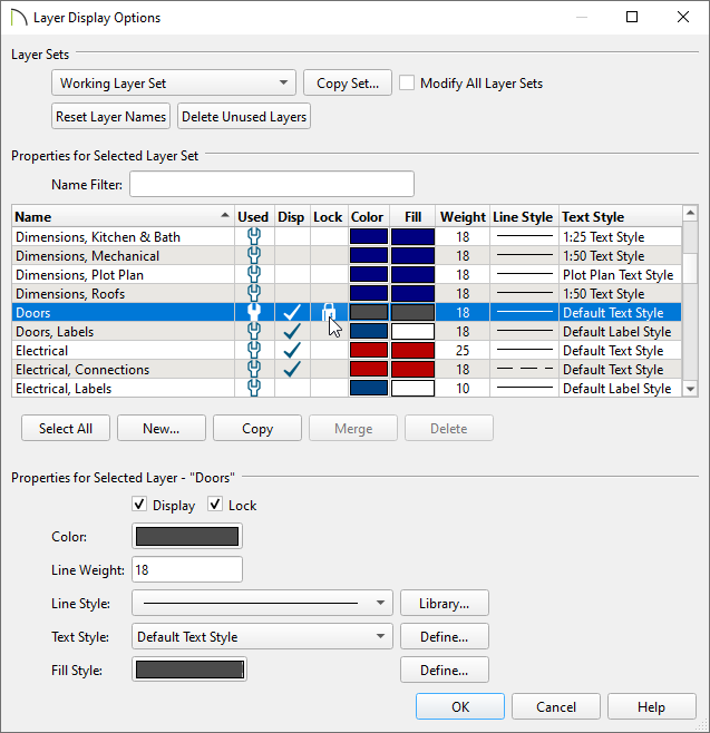

  2. Select Tools> Layer Settings> Display Options from the menu and lock any layers you don't want the user to modify, then click OK.
    Note: If your client or colleague is using Home Designer 2026 or newer, or Home Designer Pro, they can still unlock/lock layers.
    Locking the Doors layer in the Layer Display Options dialog

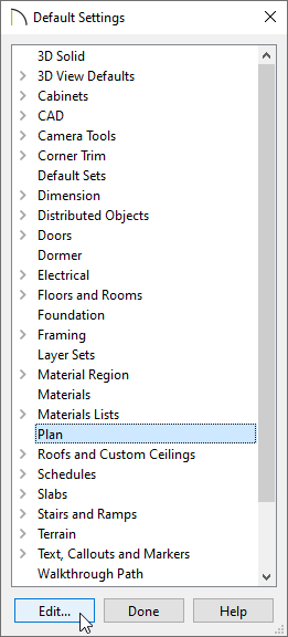

    If you're using X17 or a prior version, select Edit> Default Settings , and in the Default Settings dialog, click on either Plan or Layout, then click Edit.
    Select the Plan option in the Default Settings, then click Edit

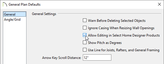

  4. In the General Plan/Layout Defaults dialog that displays, check the Allow Editing in Select Home Designer Products box, then click OK and Done to close the dialogs.

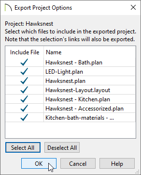

    • In X17 and newer versions, with Project Management enabled, navigate to File> Export> Export Project  while a plan or layout is open, or right-click on a single project in the Project Browser  and select Export from the contextual menu. In the dialog that appears next, check/uncheck the files that you would like to include/exclude using the Include File column, then click OK.
      Export Project Options dialog that appears when exporting projects using Project Management
