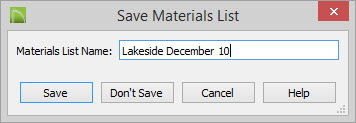

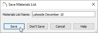

- When you have made the necessary changes to your materials list, select File> Close View or navigate to Tools> Active View> Save Active View
- In the Save Materials List dialog that appears, type a meaningful name for this materials list, then click Save.
Your materials list will now be saved and available for access when this plan file is open.

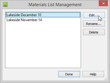

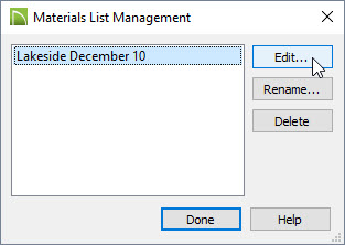

To access a saved materials list
- Select Tools> Materials List> Materials List Management
to open a list of all saved materials lists associated with the current plan.
- In the Material Lists Management dialog, click on the materials list that you would like to open, then click the Edit button.
- The selected materials list will open and can be edited, printed, or exported for use in a spreadsheet program.
