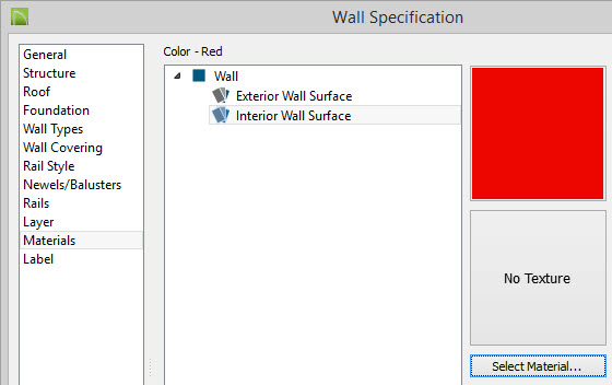

To change the color or material of a single wall using the Wall Specification dialog
  1. Select the wall you'd like to change the material of, then select the Open Object edit button.
  2. In the Wall Specification dialog that appears, select the Materials panel.
    Wall Specification dialog on Materials panel with Interior Wall Surface selected
    • Click on either the Interior or Exterior Wall Surface component, then click on the Select Material button.
    • In the Select Material dialog that opens next, choose your desired color or material, then click OK.
    • Click OK once again to close out of the dialog and confirm the change.
