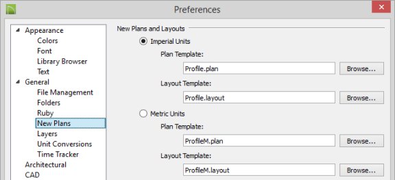

To specify a plan or layout template in Chief Architect
  1. Select Edit> Preferences Preferences from the menu if you're on a Windows computer or Chief Architect> Preferences Preferences if you're on a Mac.
  2. On the New Plans panel of the Preferences dialog, click the radio button beside the measurement system that you typically use: Imperial Units or Metric Units.
    Preferences dialog opened to the New Plans panel.
  3. A Plan Template can be specified underneath your selected measurement system. Click the Browse button to the right of the Plan Template field, then select the plan file that you would like to use as your template.
    • The Select a Plan Template File dialog will open to your Chief Architect Templates folder. Choose a template plan located here, or browse to a different location where you have a custom template saved.
    • Only choose a template file with M.plan at the end of the name if you are using Metric units.
      Never specify a .layout file as your plan template.
    • To avoid the possibility of the program not finding your specified template, make sure it is saved on the local hard drive.
    • To learn more about creating templates, see the Related Articles section at the end of this article.
  4. A Layout Template can also be specified in the same way.
    • Only choose a template file with M.layout at the end of the name if you are using Metric units.
      Never specify a .plan file as your layout template.
