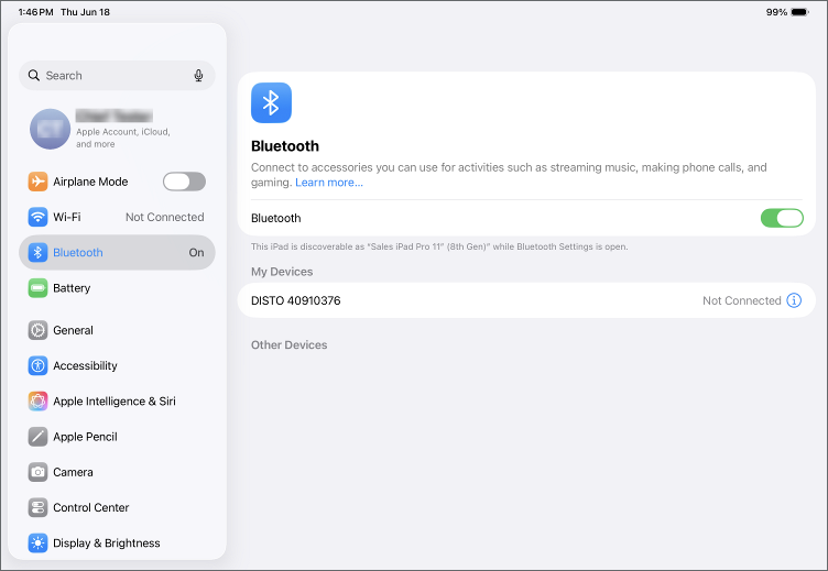

  1. Turn on bluetooth on the Apple device.
    Do not pair your Apple device with the bluetooth measuring device in the device settings.

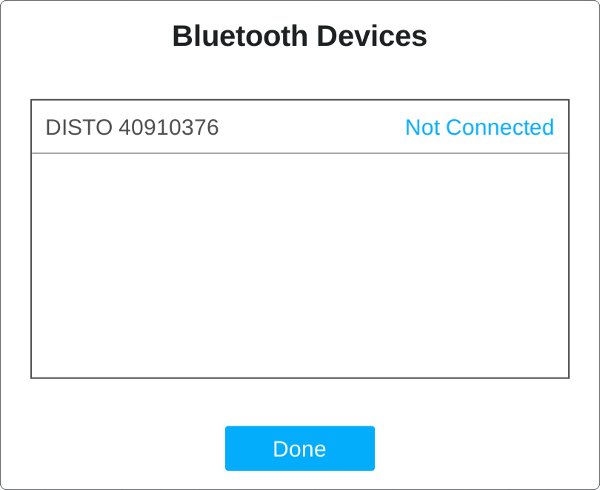

  3. Select Bluetooth Measuring Devices at the bottom of the Settings menu to open the Bluetooth Devices dialog.
    You should see your bluetooth measuring device in this list with the words "Not Connected".

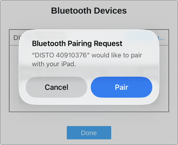

  4. Tap on the name of the bluetooth device to start the pairing process. If prompted, click the Pair button.
    Click the Pair button if prompted

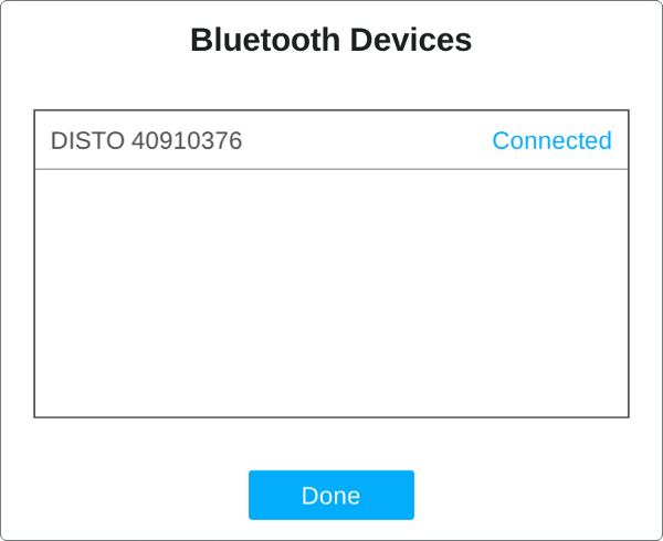

    Once paired and connected, the word "Connected" should display in the Bluetooth Devices dialog, as shown below.
    Note: If the device fails to connect, tap on the device name once again. If you're still unable to connect your bluetooth measuring device to As-Built, restart your Apple device, disable and re-enable the bluetooth functionality within your device settings, then repeat Steps 2 - 4.
    Disto is connected and shows as such in the Bluetooth Devices window

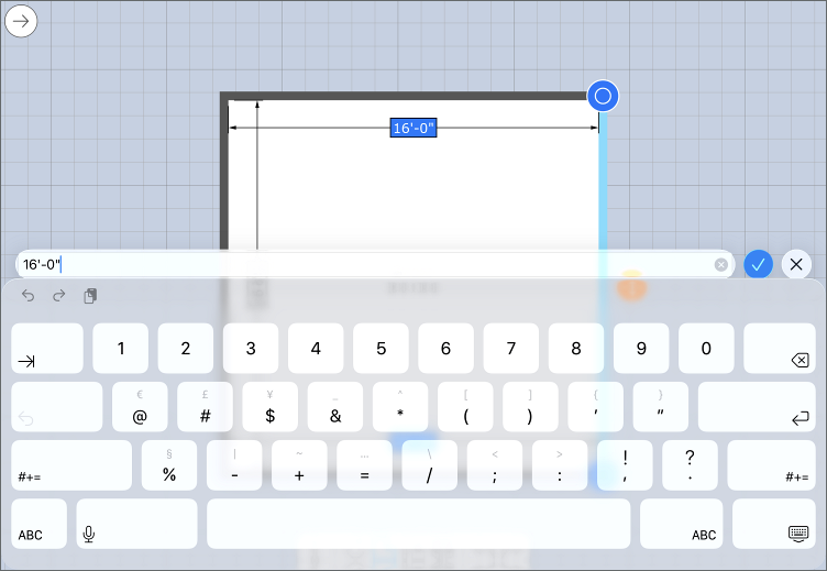

  6. Tap on the wall that you'd like to move, then tap the blue dimension box that is adjacent to the selected wall to bring up the keyboard along with an input line.
    Note: Some bluetooth measuring devices will not prompt the keyboard to appear. Instead, only the input line will appear; continue with the steps below.
    Tapping on a blue dimension value to populate the keyboard or input field

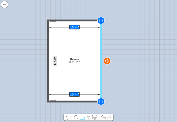

  7. Capture a measurement using the bluetooth measuring device, and notice that the captured measurement will override the value that was originally set.
    As you can see in the image below, the measurement captured with the bluetooth measuring device was 10' 4".
    Wall has adjusted to 10'-4", which is the value captured from the bluetooth measuring device
