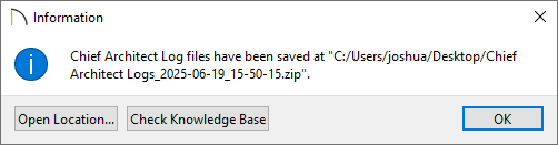

  3. An Information dialog will display with the location the logs have been saved to; click Open Location or OK.
    Note: When performing this action, all of the log files are exported to a single zipped (compressed) folder.
    Information dialog that appears when exporting logs
