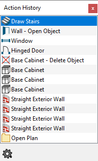

    • Actions are listed in chronological order with the most recent at the top of the list. The selected line item is highlighted and reflects the current state of the file. Items below the selected line item are past actions that can be undone.
      Action History side window with several different line items

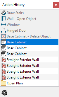

    • Clicking on a prior line item will make that action the most recent and effectively undo all line items above it.
      Undoing actions using the Action History side window

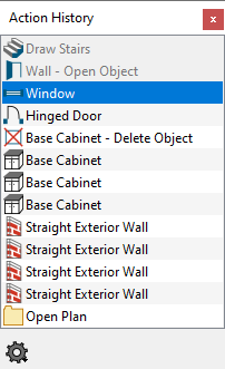

    • Clicking on a gray line item above the selected line item will redo any actions up to that point.
      Clicking on a gray line item to redo actions

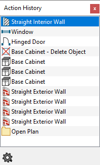

    • Once a new action has been initiated, all gray line items above the existing selected item will be removed and can no longer be referenced or selected.
      Creating new actions after undoing prior actions
