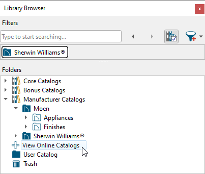

    • Expand the Chief Architect Bonus Catalogs and/or Manufacturer Catalogs subfolder(s), then select the View Online Catalogs  option. Proceed to browse through the list of online catalogs that pertain to the parent folder until you have found a particular object or catalog that you're interested in.
      Select the View Online Catalogs option

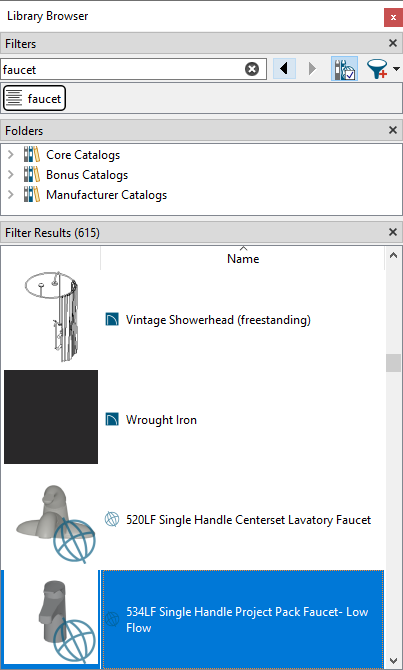

    • Using the search bar, search for a manufacturer or an object that you want to use in your plan.
      In the Filter Results area, objects that are installed in your library will display with the following  symbol and will appear in the list first, while objects that are not installed will display with a globe  symbol and will appear at the bottom of the list.

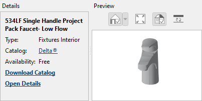

  3. Select an object or online catalog that is not installed, then look in the Details section located at the bottom of the Library Browser to see additional information.
    Details for the selected catalog.

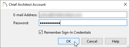

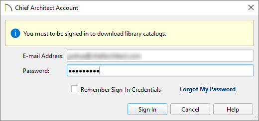

  4. Click on the Download Catalog link located in the Details section, or right-click on the object/catalog and choose the Download Catalog option to prompt a Chief Architect Account Login dialog to appear. Enter the e-mail address and password associated with your Chief Architect account, then click Sign In.
    Note: If you're already signed in to your Chief Architect account within the software, this Login dialog won't appear. Instead, the catalog will be downloaded and you will be greeted with an Information message once it has completed.
    Login dialog where an e-mail address and password can be entered
  5. If you have logged in successfully, you will receive a message stating so. Click OK. The library download will now take place in the background. Once it has completed, an Information message will display advising that "The Library Import has completed successfully..." followed by the number of items that have been imported. Click OK.

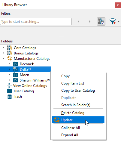

  1. Navigate to Library> Update Library Catalogs  from the menu or select the Update Library Catalogs  tool at the bottom of the Library Browser to update all of the catalogs.
    You may see the following icon  next to a parent folder, as well as in the top left corner for the applicable child folders/catalogs when an update is available. Follow the process just mentioned in Step 1 above, or right-click on the line item displaying the icon and select Update , as shown in the image below.
    Note: On a Mac, hold down the Control key while clicking to initiate a right-click command. More information about right-click commands on Apple input devices can be found in the following Apple resource: Right-click on Mac.
    Updating a catalog that has new content available
