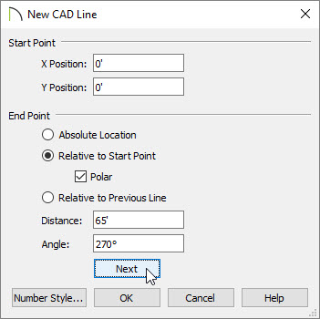

  4. Select CAD> Lines> Input Line to open the New CAD Line dialog. Notice that the Start Point is (0,0), which is the location of the current point that you just created. Click the Number Style button at the bottom of the dialog and in the Dialog Number/Angle Style dialog:
    • Select Decimal Feet for the Number Style.
    • Choose the Angle Style that matches your data, such as Quadrant Bearing or Azimuth Bearing.
    • Click OK.

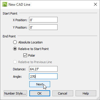

  5. Staying in the New CAD Line dialog, select the Relative to Start Point option and check Polar. Enter the length of the first side of your property boundary's legal description in the Distance field, and the angle of that line in the Angle field.
    New CAD Line dialog with a Distance and Angle specified
  6. Click Next and enter the Distance and Angle of the next property line.
    The next property line will be the one adjoining the end point of your first line, rather than the start point.
    New CAD Line dialog with a different Distance and Angle specified
    Note: With the North Pointer pointing in the up direction, an angle of 90 degrees will travel in the direction of left to right, 0 degrees will go from bottom to top, 270 degrees will go from right to left, while 180 degrees will travel from top to bottom.
  7. Continue until all property lines are entered, then click OK to close the dialog.

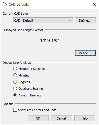

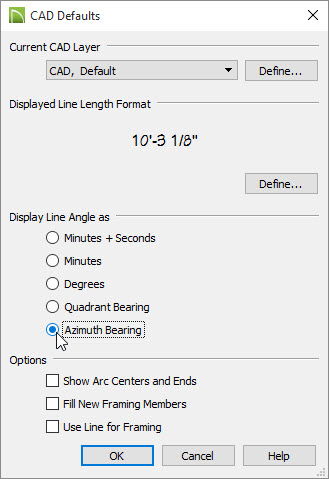

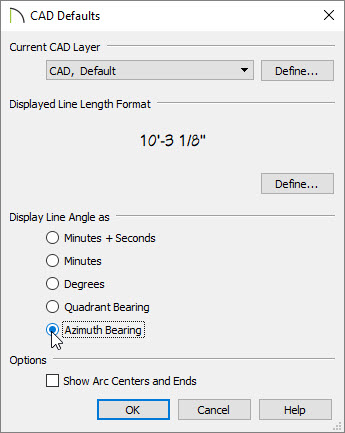

To display line length, angle, and arc radius information
  1. Select Edit> Default Settings from the menu, expand the CAD category, select General CAD, then click the Edit button.
  2. In the CAD Defaults dialog:
    Azimuth Bearing selected in the CAD Defaults dialog
    • Choose the angle display method that matches your data under the Display Line Angle as section.

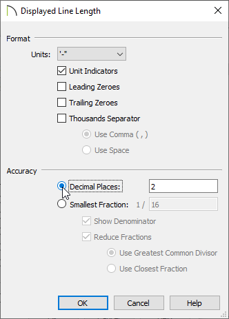

    • Click on the Define button under Displayed Line Length Format Preview to display the Displayed Line Length dialog, and under Accuracy, select the Decimal Places radio button
      Decimal Places selected under Accuracy in the Displayed Line Length dialog
    • Click OK and/or Done on all dialogs to confirm the changes.

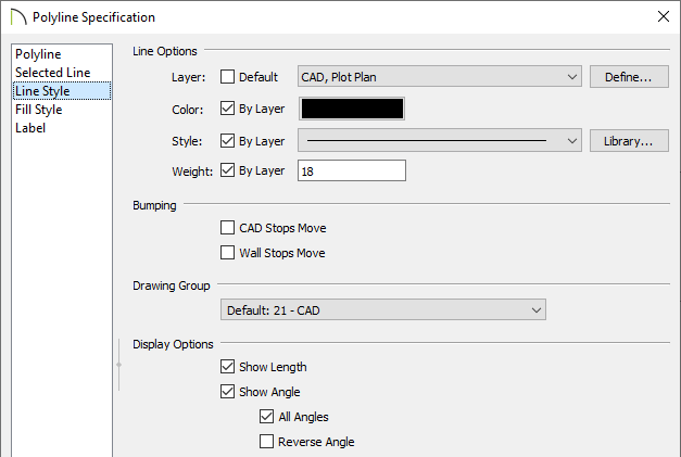

  3. Click on the plot plan polyline to select it and click the Open Object edit button.
  4. On the Line Style panel of the Polyline Specification dialog:
    Polyine Specification dialog where Show Length and Show Angle are checked
    • If you're using the Plot Plan Saved Plan View, the plot plan may already be on the CAD, Plot Plan layer.
      If you're not using the Plot Plan Saved Plan View, change the layer to CAD, Plot Plan, click the Define button next to the Layer drop-down, and ensure that the CAD, Plot Plan layer is set to be displayed.
      For more information on layers and layer sets, please see the Related Articles section below.
    • Check Show Length, Show Angle and All Angles.
    Plot plan with line length and azimuth bearing

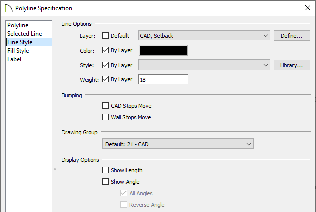

  4. Select the inner polyline and click the Open Object edit button.
  5. On the Line Style panel of the Polyline Specification dialog:
    • Click the Define button next to the Layer drop-down and in the Layer Display Options dialog that displays, click the Copy button to copy the layer, and change the name of the newly created layer to CAD, Setback.
    • Change the Line Style to a dashed line style.
    • Uncheck the Show Length and Show Angle boxes, if desired.

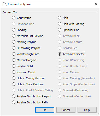

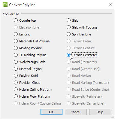

To convert a plot plan to a terrain perimeter
If you'd like to have your Plot Plan appear in 3D views as a grass pad with a thickness, you can convert it to a Terrain Perimeter.
  1. Select the plot plan polyline and click the Convert Polyline edit button.
  2. In the Convert Polyline dialog, select Terrain Perimeter, specify the Layer you would like the Terrain Perimeter to go on, then click OK.
    In the Convert Polyline dialog choose Terrain Perimeter and click OK.
  3. Make any needed changes, then click OK to close the dialog.
    The plot plan polyline that you created is now your Terrain Perimeter.
