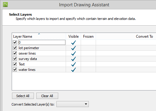

  5. On the Select Layers page, make sure there is a check beside the name of each layer shown in the Layer Name column, then click Next/Continue.
    You can click the Select All button to check all layers at once, ensuring that every layer will be imported during this process.
    Click the Select All button on the Select Layers window

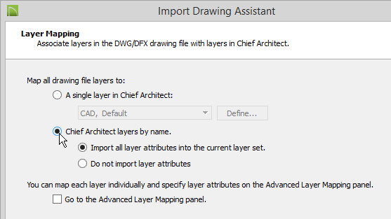

  6. On the Layer Mapping page, select the Chief Architect layers by name. radio button, leave the Import all layer attributes into the current layer set. radio button selected, then click Next/Continue.
    Choose the Import all layer attributes into the current layer set option

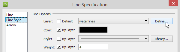

  9. Click on the polyline representing the lot boundary to select it, click the Open Object  edit button, then select the Line Style panel of the object's specification dialog. Make a note of the Layer that it is on, then click OK.
    In this example, the lot boundary is on a layer called C-PROP-BNDY.
    Find the layer the lot boundary is on

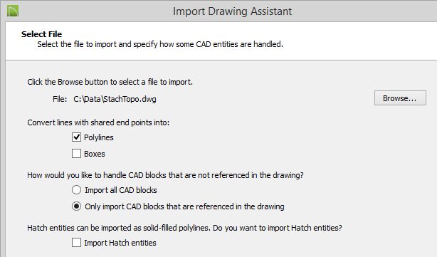

  2. On the Select File page, click the Browse button to open the Import Drawing File dialog and select the desired DWG or DXF file saved on your computer. Once the desired file is selected, click Open to return to the Import Drawing Assistant. Check the Polylines box under the Convert lines with shared end points into: heading, then click Next/Continue.
    Check the Polylines box on the Select File window

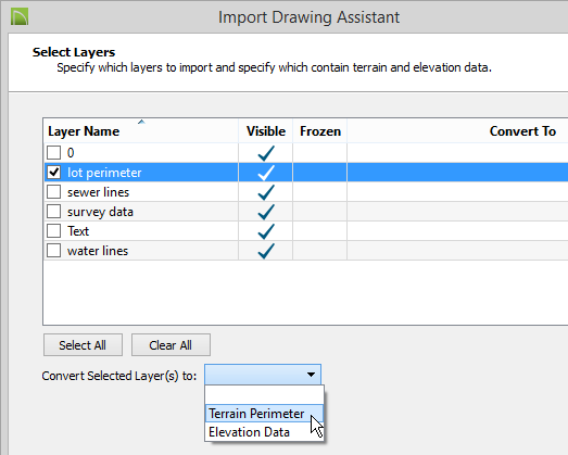

  3. On the Select Layers page:
    Choose what layers are imported and convert them using the drop-down option
    • Uncheck any unwanted layers using the Layer Name column. You can click the Clear All button to quickly, and easily, uncheck all layers at once.
      In this example, the CONT-MJR, CONT-MNR, and C-PROP-BNDY layers are the only layers selected.
    • Select the layer containing the lot boundary polyline, then select Terrain Perimeter from the Convert Selected Layer(s) to drop-down list.
      In this example, the C-PROP-BNDY layer is the lot boundary layer and is specified to be converted to the Terrain Perimeter.
    • Select the layer(s) that contain contour/elevation data and select Elevation Data from the Convert Selected Layer(s) to drop-down list.
      In this example, the CONT-MJR and CONT-MNR layers consist of minor and major contour/elevation data and are specified to be converted to Elevation Data.

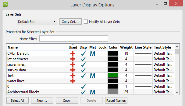

  4. On the Layer Mapping page, select a layer mapping option. Any option will work in this instance; however, you can, for example, map the lot boundary directly to the native Chief Architect Terrain Perimeter layer by checking the box beside Go to the Advanced Layer Mapping panel, then clicking Next/Continue.
  5. (Optional) On the Advanced Layer Mapping page, click on the layer(s) that you would like to remap, then use the drop-down menu at the bottom to map the layer(s) to the desired Chief Architect layer(s). Once the layers are mapped to your liking, click Next/Continue.
    In this example, the C-PROP-BNDY layer is mapped to the Terrain Perimeter layer. You could also map the contour/elevation layers to native Chief Architect layers at this time.
    You can also click on the Define button located beside the layer drop-down option to open the Layer Display Options dialog, where additional layer properties can be adjusted.
    Remap layers using the Advanced Layer Mapping page
