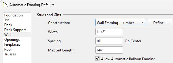

    1. In your desired plan, navigate to Edit> Default Settings , expand the Framing category, select the Automatic Framing option, then click Edit.
      In X16, select the General Framing option, then click Edit.
    2. On the Wall panel of the Automatic Framing Defaults dialog that opens, specify the desired Spacing value.
      This value is measured from stud center to stud center.
      Automatic Framing Defaults on the Wall panel changing the Default Spacing
    3. Click OK and Done to close the dialogs.

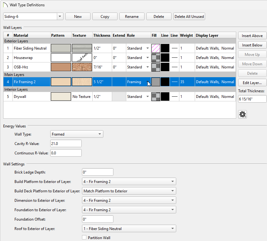

    1. Select Build> Wall> Define Wall Types  from the menu.
    2. In the Wall Type Definitions dialog, select your desired wall type using the drop-down menu in the top left corner, then select one of the wall type's framing layer(s) by clicking on it within the Wall Layers table.
      In your Wall Type Definition, select your framing layer and ensure it's Role is set to Framing.

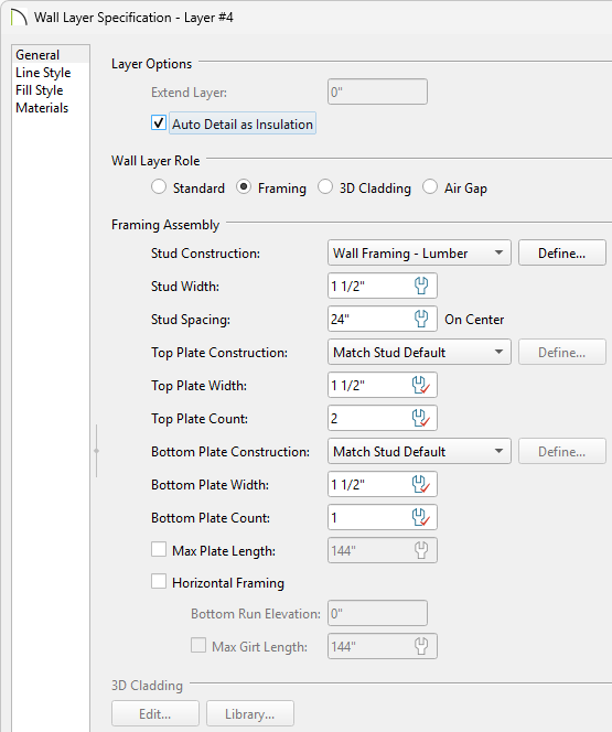

    3. With a Framing layer selected, click the Edit Layer button to the right of the Wall Layers table to open the Wall Layer Specification:
      In the Wall Layer Specification adjust your Stud Spacing
      • Ensure that the Wall Layer Role is set to Framing.
      • In the Framing Assembly section, adjust the Stud Spacing value. Additionally, you can select the Default wrench next to the Stud Spacing value to set it to match your default stud spacing, as discussed above.
      • Click OK once you've finished making your changes.
        Note: For more information regarding the options in this dialog click the Help button at the bottom to open your program's Help documentation.
    4. Make any other desired changes, then click OK to save the changes you made to your wall types.

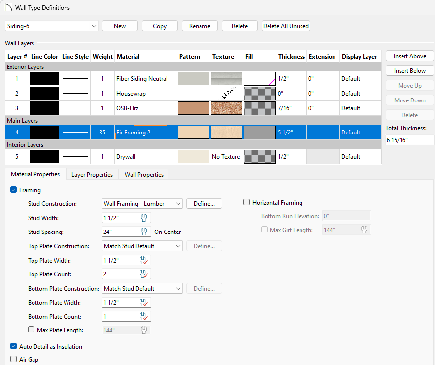

      Wall Type Definitions to change the Stud Spacing
    3. If it's not already checked, check the Framing box located on the Material Properties tab.
    4. Specify the desired Stud Spacing. Additionally, you can select the Default wrench next to the Stud Spacing value to set it to match your default stud spacing, as discussed above.
    5. Click OK to close the dialog and save your changes.
    The next time you build wall framing in this plan, any walls using the wall type you just edited will use the stud spacing that you specified.
