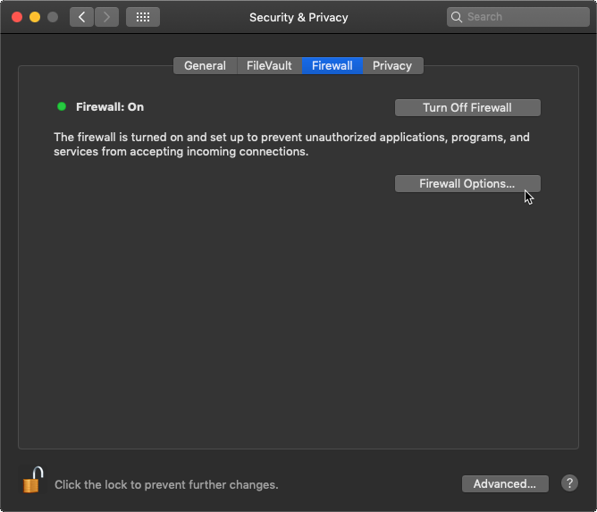

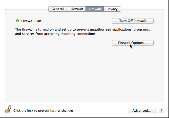

  3. Select the Firewall option, then click on the Options button.
    Selecting the Options button in the Firewall settings

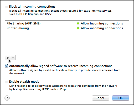

  4. The next dialog allows you to add or remove programs from the firewall list and configure how the firewall handles requests from these programs. Click the Add + sign to add a program.
    Add a new application to the Firewall Options

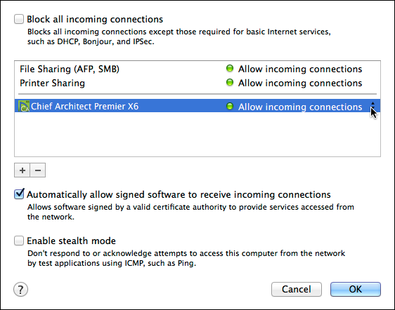

  5. In the Finder window that appears, select the Chief Architect or Home Designer application and click Open.

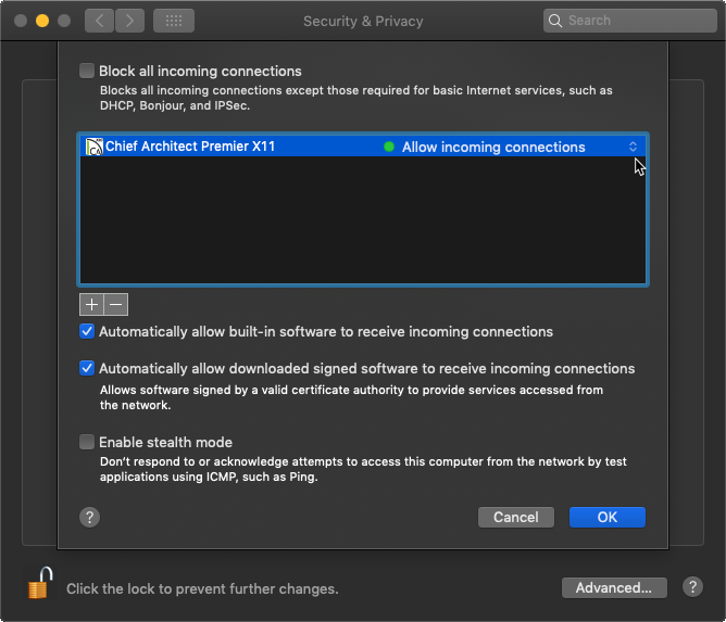

  6. Verify that the program is set to Allow incoming connections, then click OK.
    Allow all incoming connections for a Chief Architect or Home Designer program
