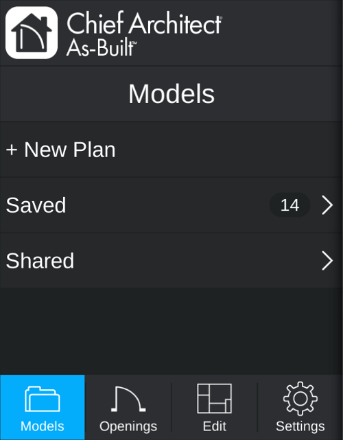

  1. Open the As-Built mobile application on your device, access the Models section, then click on the Saved menu option to see a list of models.
    Saved models

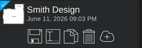

  2. Locate the model that you want to transfer or share, tap on its name, then click the Add to Cloud  icon.
    Tap the model to get a list of options, then tap Add to Cloud

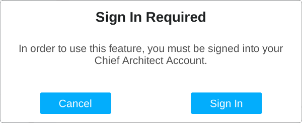

  3. A Sign In Required window will appear; click Sign In and proceed to sign in to your Chief Architect Account.

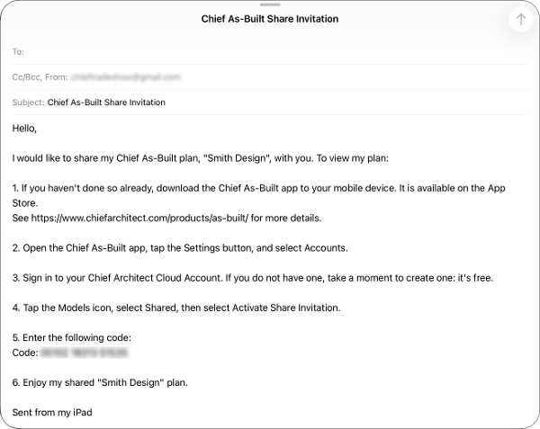

      This prompts an invitation email with additional instructions on accessing a shared model, of which can be sent to a recipient of your choice. Even if an email is not sent during this process, a share code is generated, which can be used to view the model with anyone you choose to share the code with.
      Note: A Chief Architect Account is required to view As-Built models. A Chief Architect Account is free and can be created by clicking on the "Register" option within the As-Built mobile application or by signing up here
      Share Invitation email
